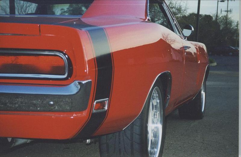

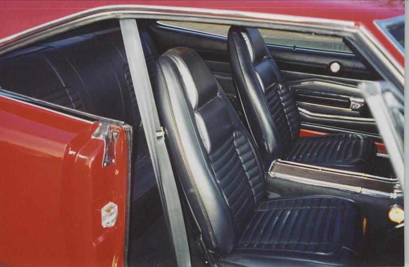

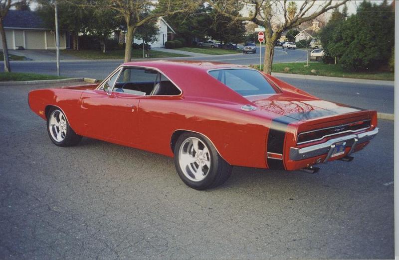

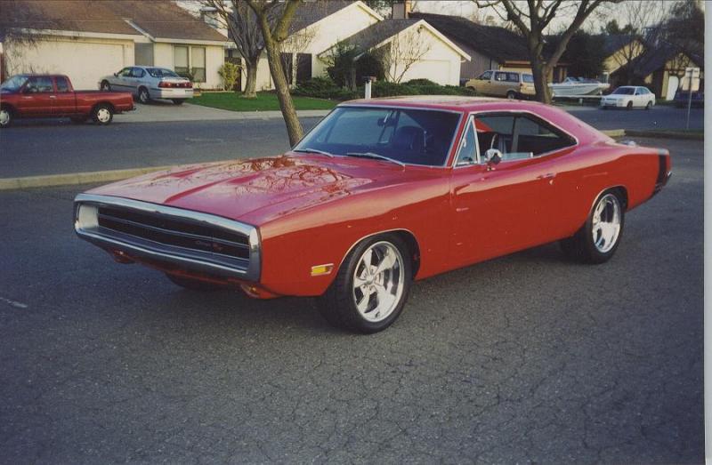

I have pictures of the car but nothing yet of the suspension. I probably should. One thing about these 68-70 Chargers, and maybe others that I don't know about, is the odd design of the outer wheel tub. Instead of the tub following the contour or the quarter panel, it goes inboard towards the middle of the car a few inches, THEN up. This makes it hard to run the wheels and tires out to the edge when the car is lowered.
Heres a few shots of the car.
that looks great! are you going to go any lower? i am have the same problem with the inner wheeltub deal on my duster.
wow awesome looking car
