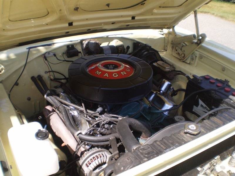

I went with 68-69 HP manifolds on my mostly stock 67 383. Main reasons are that I like the stock look and didn’t want to deal with getting headers to fit.
The cam is only slightly warmer than stock. With the factory 4 bbl intake and stock heads, I suspect the engine is more flow limited there than on the exhaust side.
