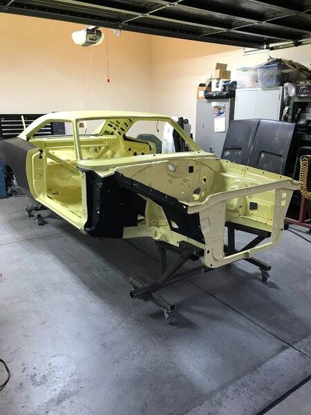

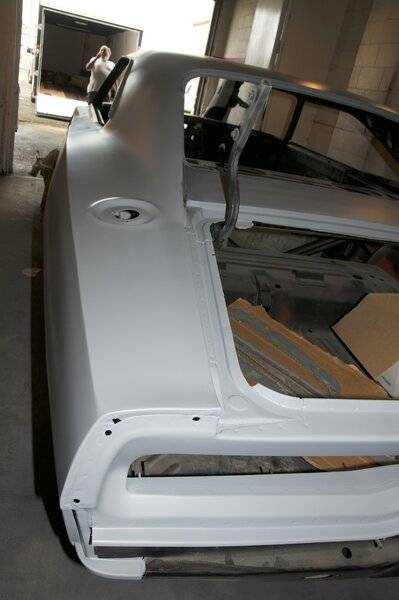

The Fritz R/T is finally out of painters hell and safe at home. After telling this guy I plan to use PPG, he applied Dupont primer. Now I'm going to have to put sealer over that according to my paint supplier. This guy also told me that PPG does not make T5 Copper. Not true. So I'm glad I'm outa there and will take over from here. I'm happy as a pig in sh*t!

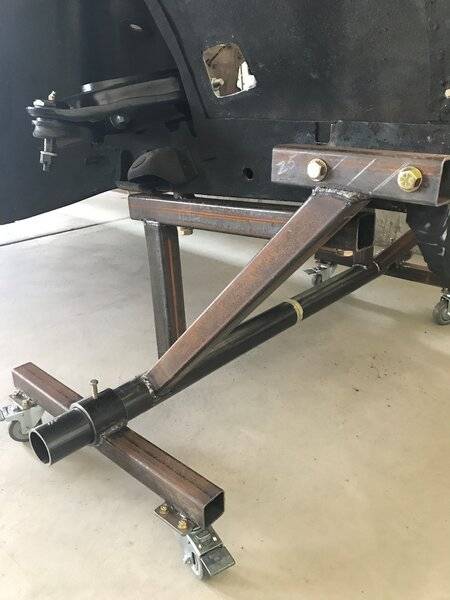

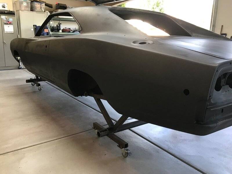

I'm building a body dolly cart for it rather than pay anywhere from $600 - 900 for one. I'm using 3/16 steel tubing and I don't think the ones I've seen online are that heavy duty. The wheels cost more than the steel.

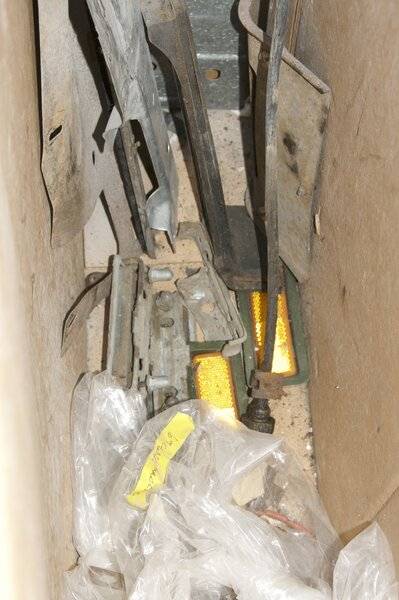

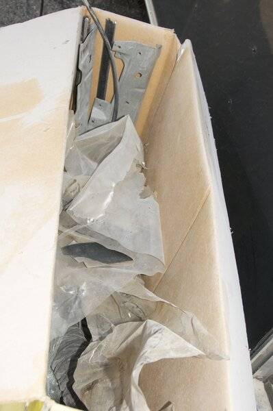

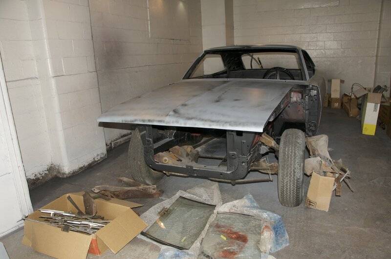

I've seen posts about people asking if other car owners had their parts end up with all kinds of bondo dust and overspray on them. Here are some photos of the condition of my original parts when I went to rescue my car. You can't see it because it had all kinds of stuff piled on top of it but my antenna was just dumped in that box. I'm lucky it didn't get bent. I had a lot of the parts that I have restored sitting in boxes on shelves at home so they were safe!

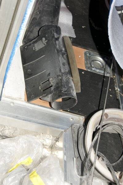

The perfect AC under dash control unit was loose in all that stuff.

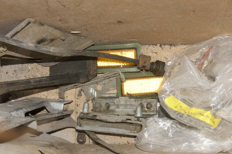

My nice original side markers at the bottom of a box of stuff.
Honestly your lucky those parts still exist.. Body Shop Hell eats small parts...
If your using PPG envirobase you will have to seal it for even coverage.. just incase there are any break throughs from sanding the primer.. I dont mind Duponts primer. its a direct to metal product.. as where PPGs stuff is not..

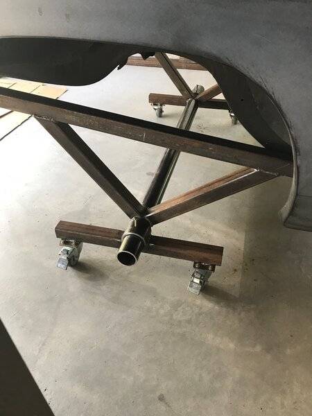

I feel ya brother. Sucks when your pride and joy is mishandled by unappreciative people. I built mine with salvaged steel, cost me 45 bucks. The casters I dug out of the dumpster at work, (why they're kinda small but do the trick). Basically wanted to simulate the actual flex points in the chassis by using the existing K frame and rear spring mounts. Hey it works for me and I can tell ya it's nice to be able to move the car any which way you want.. by yourself.
Brut strength and shear stupidity prevails :thumbsup:
View attachment 961487 View attachment 961488 View attachment 961489 View attachment 961490 View attachment 961491
Nice design!

I don't doubt what you're saying, it's a matter of what PPG will guarantee. I'm pissed that I told the guy not to paint it until he talked to me about my decision about which one I want to use. He said: that's not paint, it's primer!:mad: Not to mention he claims to have done body work to the quarters but doesn't have any photos.

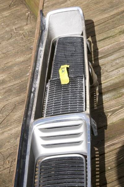

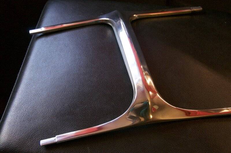

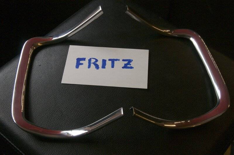

Couldn't keep the original paint. I want a screaming paint job and the original was not in good condition. I know what you mean - I picked up the front grill and headlight frame a couple of mos ago. Apparently it's too much trouble to lay a piece of plastic over it because it had so much dust etc on it, it was a different color. A friend of mine arranged for me to work with a painter in a body shop for six mos to learn how to do body and paint. Watching youtube helps a lot as well and the actual experience made it easy to understand. If you've ever detailed a grill like this, you know what a pain in the *** it is to deal with that "waffle" pattern. I have completely removed the trim and polished it, which shops usually won't do and if they did, you're nose would bleed for a week.
The bottom of the I beam was dented, maybe from installing the bumper. I knocked the dents out and then polished it.
So there is no anodizing on the trim right? You polished it off. Wont polished aluminum tarnish, or oxidize?
Yes, it will. There are several products available that will protect the aluminum such as: Everbrite, Sharkhide, and others. It can also be reanodized.
