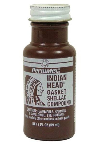

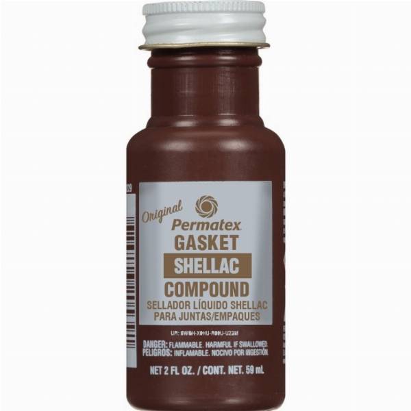

Had 2 plugs leaking that my engine builder put Indian head on them. Knocked them all out and put The Right Stuff Black on them. No leaks Now.
I heard the "woke" version of indian head without the picture of the indian doesn't work as well. Maybe you got a bottle of the woke stuff. :lol:

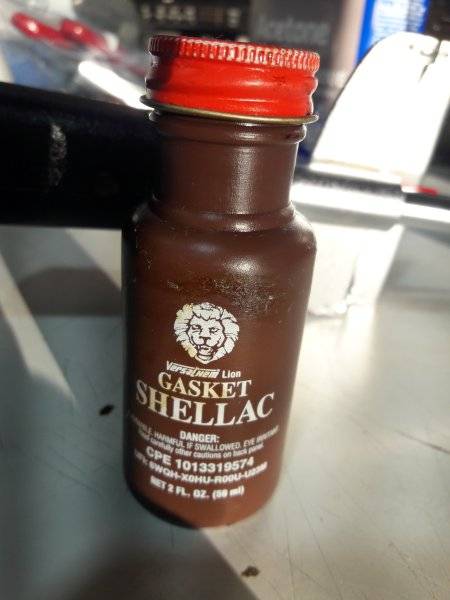

How about the Lion Head version?
