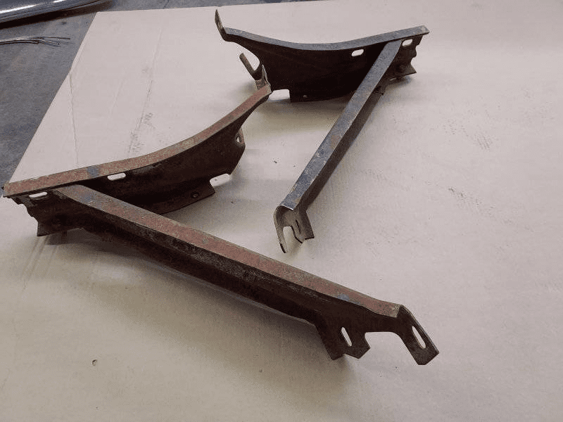

Working with old beat up cars is fun! So are 50 year old collision fixes. I’ve made modifications to my front bumper bracket to give me more adjustment range in and that worked fine. However I need to laterally adjust the bumper to the left (driver side) (see picture for reference) about an inch.
I can’t see a way to do this. Does anyone have any ideas?

You might be able to shim the brackets that mount to the frame rails but you won’t get an inch. Your brackets are bent and need to be bent back to shape. You could bolt them on without the bumper and encourage them with a sledge hammer or long pipe, something to get leverage. This should have been done before paint though, man! Now you’re risking scratches

Kind of hard to explain, but the support brackets are slotted where the bumper bolts to it, I don't know if you'll get an inch adjustment left and right, but should be able to at least improve it. You'll need to loosen all bumper bolts where they attach to the bumper. I was able to "bump" mine to the left quite a bit. Dropping bumper down, only gives access to bumper bolts that otherwise you can not get to without removing entire assembly. By leaving rear frame bolts intact, but loose you can keep checking adjustment left and right.
Well I am not sure I would call those slots lol but I guess I can slot them more and get what I need then. It’s just a PITA doing that. Was hoping there was an easier way.
Kern Dog sounds correct...the bumper brackets are bent. If by any chance you find out the FRAME rails are bent (hope not), then making modifications to the brackets would make the most sense. First, I'd see if one/both brackets are visibly bent and bend them back if I could. Second, I'd modify the holes in the brackets and oval them out to see if I could get more movement to the driver's side. Third, I'd buy a new set of bumper brackets and try with those. Whoops! And before any of that....put on the bumper you plan to run first (as mentioned)
Thanks guys I missed KD’s post. Yeah the brackets are not the strong accident wise but bending the back is a pita as well. I think I’ll slot out the brackets as this will give me the best adjustability. I’ll use the new bumper as well just to make sure but Il have good adjustment range regardless. Love cutting slots in steel!

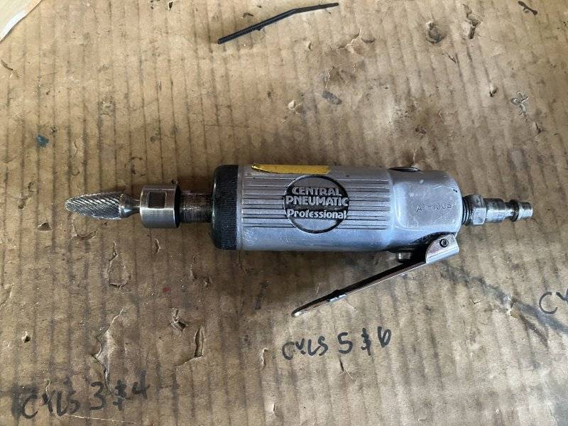

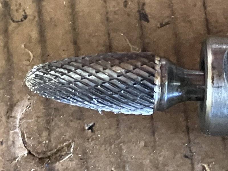

I use a air die grinder with a deburring bit on it. It turns faster than a drill and you have better leverage.

Borrowed picture, but definitely slotted somewhat LOL.
Thanks I couldn’t see it with the bumper in. I did run out and loosened all the bumper bolts and got a little movement. But it was in the wrong direction and it wasn’t but a 1/2”. So I will slot them the other way and post my results.
