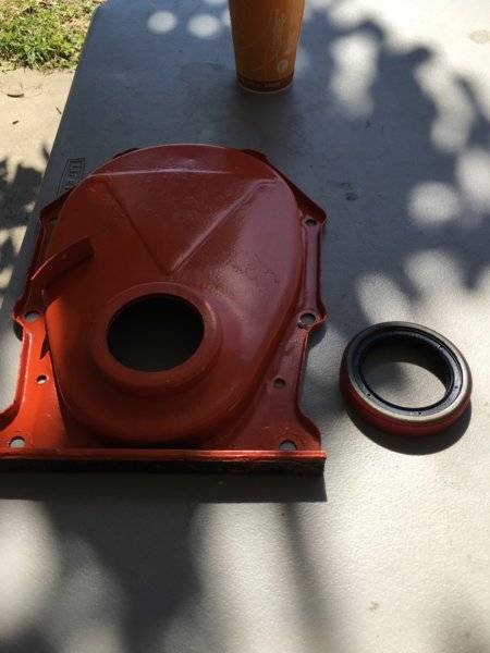

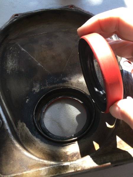

Ok folks got a question here. I’m getting ready to reassemble my timing chain cover but ran into a speed bump. Here is my cover and new crank seal. Question is how does this seal get pressed on? It almost looks like it’s too big. Any help would be appreciated.
I took different pictures as reference points.
Ok I feel dumb. The older crank seal is still in there isn’t it? I suppose sometimes it helps to post and see your mistakes.
