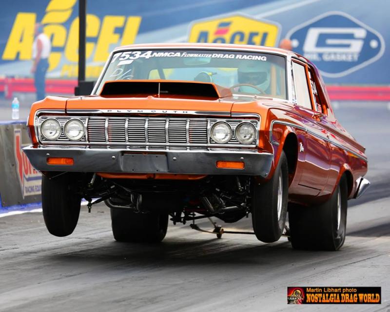

The original stuff works flawless when in good shape. I run close to 150 mph with my 64. Original 1964 ball joints, inner tie rods and pitman arm. Bushings are new, as is the Idler arm. Toe pattern is zeroed out with adjustable height heims in place of the outer tie rods. Wheels up and everything stays straight and square.
Doug
It's a shame you didn't find the problem before dumping a couple grand in it, like others are saying the original works great when in proper working condition.
