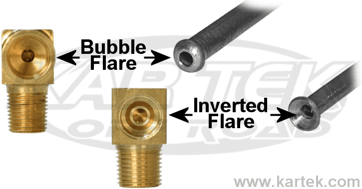

a little bubble.. that's just me though.. some people don't flare but i'm crazy paranoid about random gas spraying around, every bit helps :)
Yep, a little bubble flare would be perfect for mating to rubber hose with a clamp. For steel lines, a single flare would be ok. Brake line you buy pre flared will be double flare of course. If you are using bulk steel line, you could use either flare.

I like to use a bubble flare. With the low pressures involved it’s probably not critical but it does give me some peace of mind.
But it looks sexy and I would like to know how to do it. It does looks more functional than just slipping it over the tube.

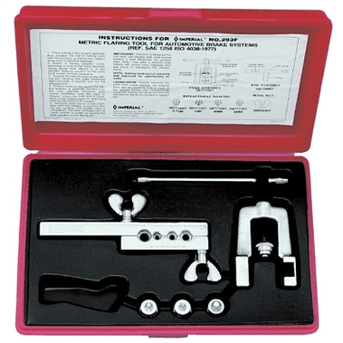

I have a regular flaring tool. What should I be looking for?

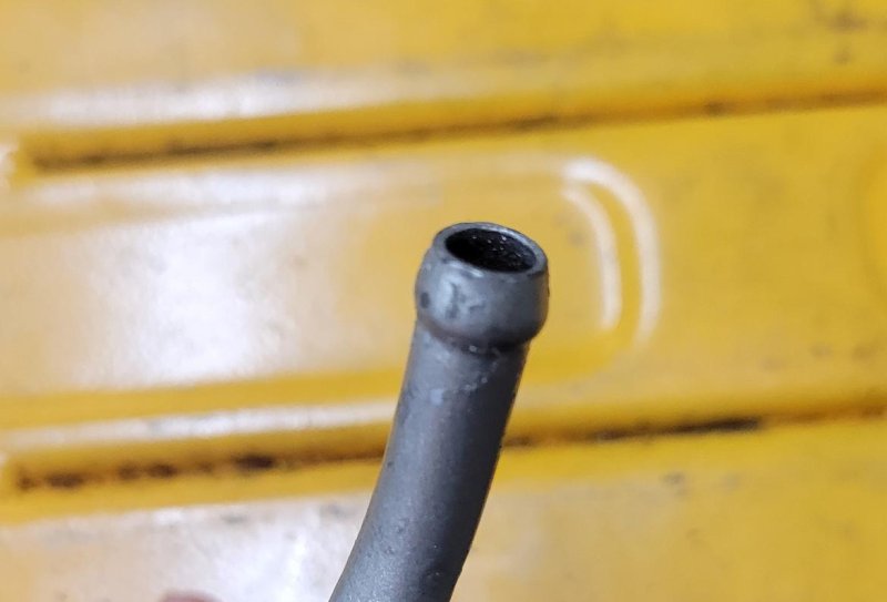

For the one in the pic i posted way up top which technically isn't a bubble flare.. i just use my flare tool and start the flare and stop when it just gets where i want instead of following through...

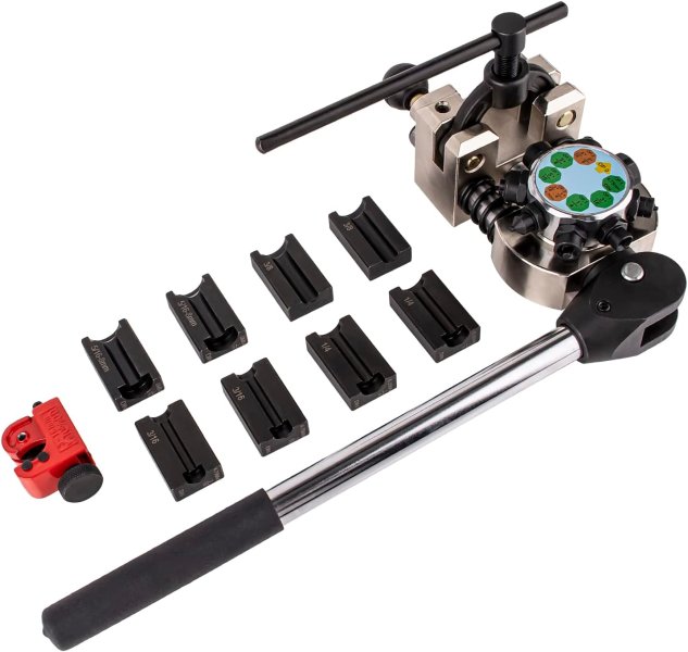

This tool is one of the best things i ever bought.. $69 and i will never use the old flare tools again.
BUT.. pretty much like this.. just don't crank it down so hard to where it flattens...
