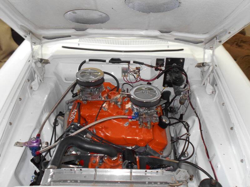

I have 2 eddy 750s on a crossram.
I had the exact same set up, identical to your system except no return line. You won’t look back by upgrading to a fuel cell and checking/having adequate fuel volume.
Is your crossram the Indy 440-25?

Factory Style
Factory Style
That’s interesting. You’re running 10.8’s with it already. Will be interesting to see some new numbers.

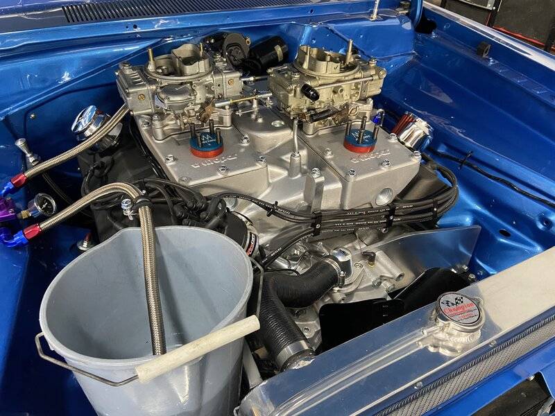

While installing new brass floats in my 770’s today I did a fuel check for comparison for you.
My system is:
11202 Pump. 350GPH,
Magna Fuel dead head regulator,
Regulator Pressure 5.5 PSI
1/2” #8 Fuel line from fuel cell to Carbs.
Fuel line removed from one carb to can:
1 full gallon in 20 seconds.
My system is:
11203 Pump. 350GPH,

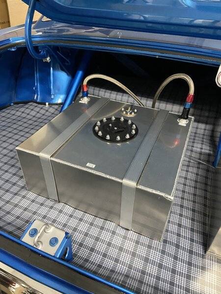

I finally got fuel cell, new pump, regulator and filter installed. I ran the car out on the road last weekend held 5-1/2 psi no more creeping. Hopefully next year can take it the strip.
