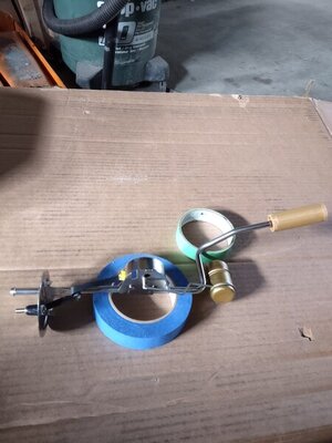

I heard stories of the sending units not being bent correctly to reach the bottom of the tank. I tweaked mine a little so the end of the sock is just touching the bottom of the tank. It goes in at about a 30 degree angle, so the sock is not parallel to the bottom of the tank. I also found that the float was not parallel to the pickup tube and it sat about a half inch high at its lower stop. I bent the arm so it is just shy of touching the pick up tube when sitting on the lower stop. Does this sound correct?
