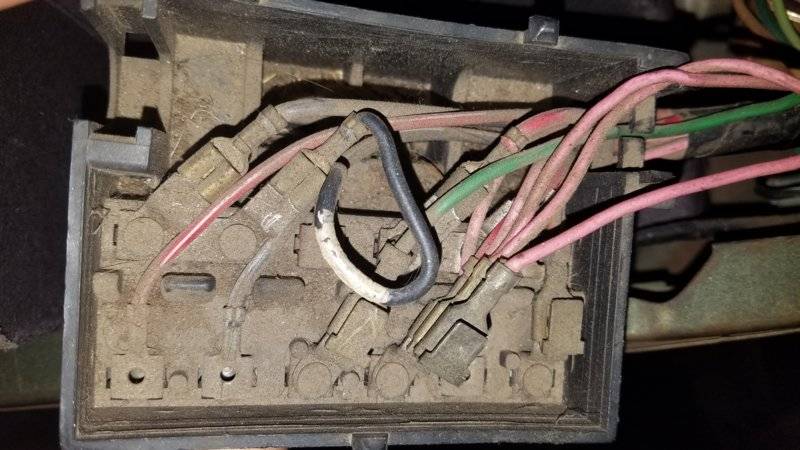

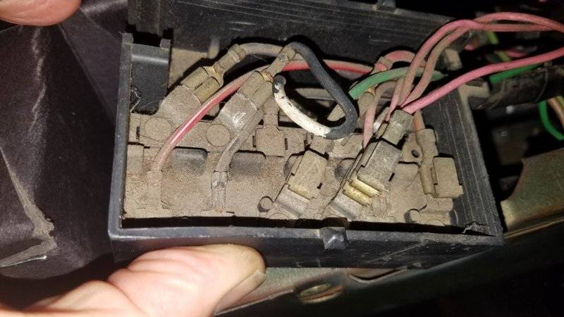

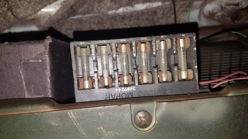

I want to replace the fuse clips and terminals in my 68 block. The plastic blocks are on ebay but mine is ok, I'm just looking to change out some rusty clips...anyone know who sells them? Some of them have a male spade(some have multiple spades stacked) on the backside of the block and some are just the clip crimped right onto the wire..Thanks

Some of those things are pretty funky looking, I hope they just snap through the block? It kinda looks like the two upper ledt ones are all one piece..
If they are not pitted...They appear to have surface rust but look reusable....You can just clean them up....Yes they come out as one unit for each row.....They are easy to remove...
The ideal way is to remove the whole harness.....Pop out the terminals and glass bead them....Then I coat them with Dielectric grease....
I was wondering this too. If I can just pop them out of the block and clean them up, I shall..That may be the ticket! I don't have a glass beader but I imagine some fine sandpaper and contact cleaner would be ok.
The stacked terminals are just that, using that type terminal on each wire. (I call 'em piggy-backed.) Just separate each one, to clean. The block fuse terminals are held in, by small tabs on each side. Some parts are steel. Cleaned mine with a brass brush.
Once all the dirt is off everything, harness loosened, terminals loose, I soaked all mine in lemon juice. Citric acid...cleans corrosion off, and brightens them.
A little follow-up. Yanked a pretty decent complete block out of a 70-whatever RV. I'll be using some of the terminals from that, that have the common buss piece riveted to them. There is one with 3 fuse clips and one with 2, just like my original. For the individual fuse clips, AND the piggy-back blade terminals I found them here:
http://www.delmarwire.com/
Fuse clip part #s 18-90 and 18-91, stacking blade terminals #18-16. They're down in Ontario CA, I dealt with the owner directly...
