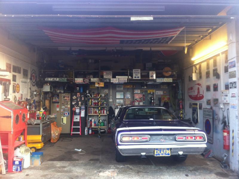

Nice garage Adam, that's something I really need "a blast cabinet".

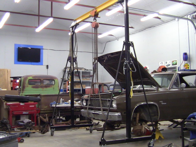

I don't have a hoist, yet, so this gantry was an awesome investment. It has a 1 ton capacity and it raises and lowers depending on space. It probably goes as low as 8' and as high as 12' but I haven't measured. I think I got it for $400 +/- on sale. I have used it to drop k-members, pull engines, load and unload my trailer. I even picked up the back end of a 99 Tahoe to change the diff. I would not have thought it before, but now it is invaluable.
Can you post the brand name/where you bought it? That's cool as hell and if you got it for $400 that sounds like a deal
I got it at Princess Auto a couple years ago. It was on sale at the time. Regular is $499. I'm not sure if they still have them though. At least not at my store, and it doesn't look like they have them online either. Here is a link....
http://www.princessauto.com/pal/en/Shop-Cranes/1-Ton-Gantry-Crane/8303091.p
I just spoke to Edmonton Alberta, North Store, they have three available @ $499.99 Cdn.
