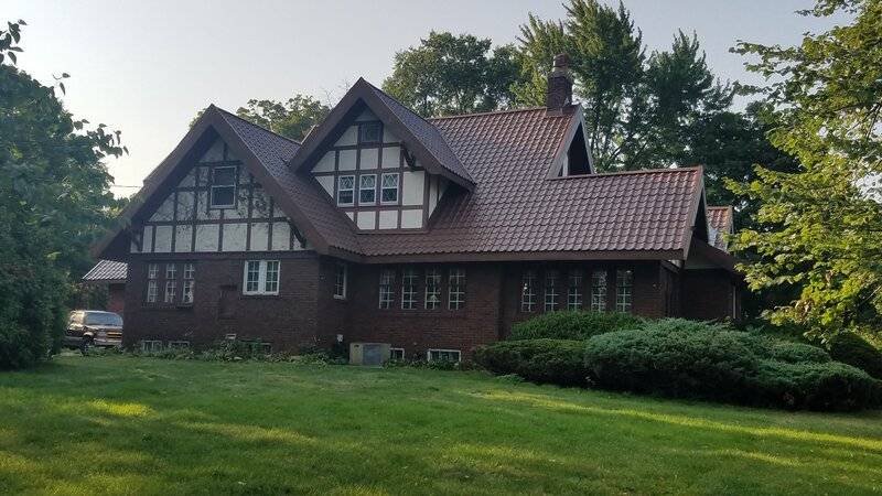

How big is your roof and how wide is your gutter? I had 4" gutters with 2x3" downspouts and they were always plugging up, way too small. When we did roofing, I went to 5" and 3x4" downspouts and they stay quite clean.
I went 3x4 too, and 6” gutters. Solved my problem.
Thanks for the responses, I'm going to look into more downspouts (nice house, mike!) that is the best way to go. Not due for roof yet but will use the storm guard for that job as suggested.
