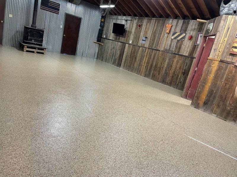

I used Ballistix it’s heat resistant to 1200 degrees, Mildew resistance, it’s UV resistant. 5 year warranty so far so good it looks amazing and cost way less then epoxy. But my floor was just poured just had to clean it really well. Epoxy will come up. This is before and after.

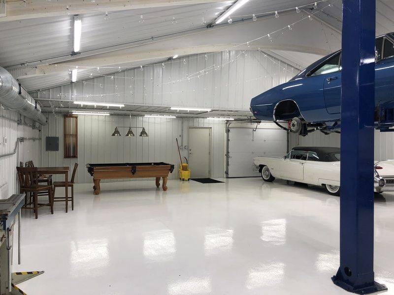

Just had my shop done. I went with the Polyaspartic Polyurea because it is supposed to be tougher than the epoxy. It came out really nice. I am not sure how much the end result differs based on the workers who are applying it, but my floor is less slippery now than the plain concrete was. Definitely has a textured feel to it. The only negative to it so far is that it is too nice. I am going to have to cover it when painting, protect it from certain chemicals, and I will probably put plywood under jackstands and such.

I don't know. It was only done last week. I probably will wuss out and run the floor jacks over plywood. I am a little worried about the steel wheels biting into the coating. I was actually checking into those airbag jacks as an alternative. I don't have a car dolly yet, but I do need one and will be looking for one with the polyurethane casters.
