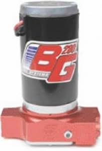

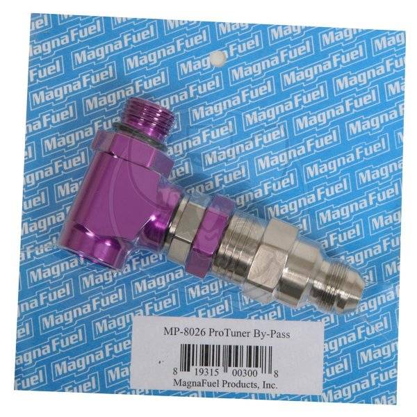

I have a BG 280 pump and have a new style bypass from Magnafuel that is plumbed into the outlet of the pump. I have -10 into the pump from the cell and have 1/2" aluminum line to the regulator.

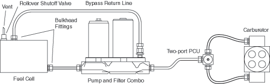

Under what theory does this new by-pass operate? I take it your regulator only has one inlet and outlet? Does the by-passed fuel return to the tank? Is this to avoid overheating the fuel? Do you have a gauge before and after the regulator? There, that's enough questions!
Mike
The bypass just sends the excess fuel back to the cell right after the pump. This way I don't need to plumb a return back from the reg at the carburetor.

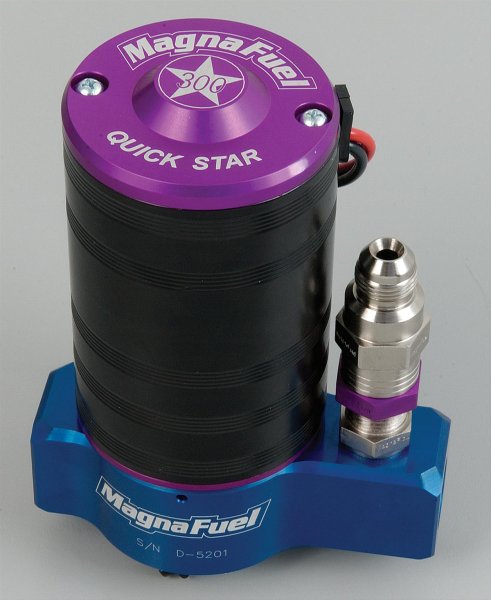

Here is a pump with the bypass built into the pump.
I'm not sure why that matters. The bypass just sends unused fuel back to the cell to keep from sending 280 gph to the deadhead regulator when the engine doesn't need it.
I was going to use a return style regulator but then I found this trick little bypass valve deal from Magnafuel.
Save a bunch of time and money on plumbing a return.

I use a performance engineering pump that is similar. It sends 30 psi to the front. Then is regulated down to 5 1/2 psi to the carbs. Only issue was the spring in the bypass. with a 16 volt battery couldn't turn the pressure down below 40psi without exposing the O-ring. The front regulator couldn't deal with 40psi. Took the rear bypass apart and cut the spring shorter. After that it worked like a charm.
