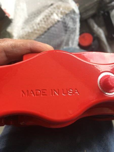

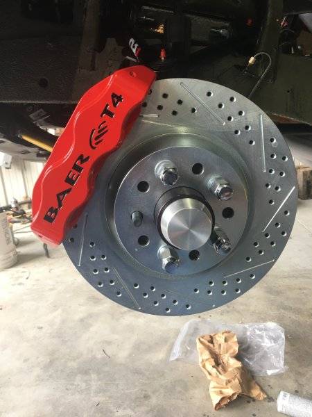

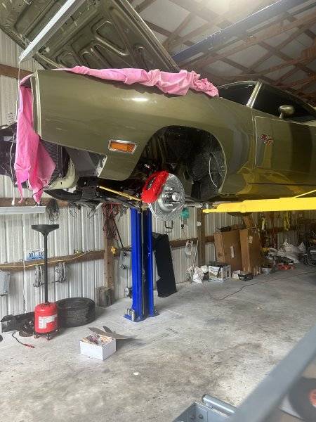

I really like these Baer brakes. The install process went pretty good. I had to grind on both spindles a tad to get one of the caliper mounting brackets on which it states in the instructions. The shimming part to get the calipers centered took a few extra minutes. The only thing that really pissed me off was they sent me brake lines for rear mounted calipers and they are about 4” short from my other ones and I don’t why they don’t use the Mopar thread size on their calipers so I could have least put my originals braided lines on it. I planned on some test and tuning this week and that was shot to ****. Made in the USA though.

I had factory disc brakes on the front and Wilwood I’m thinking only offers a 11” for factory disc spindle. I called Baer and man their customer service was great. I was torn on choosing a 6 piston or a 4 piston because their 6 piston was like $2600. I gave him my set up. What car, tire size and so forth and told me the way their 4 piston was designed it would be all I ever needed. Now he said if I was running a bigger front tire like a 285 and planned on some Auto Cross he’d recommend the 6 piston. I do like how big this 4 piston caliper is made but it’ll probably be another 3 or 4 weeks before I can do some serious driving. I may do rear disc this winter.

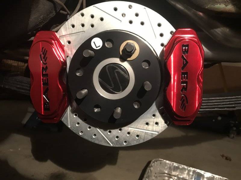

My girlfriends father has the same Baer brake set up as you, he mounted his on the rear of the rotor. If he would’ve mounted them on the front, the sway bar would’ve interfered. Is there a reason why you wanted them on the front?

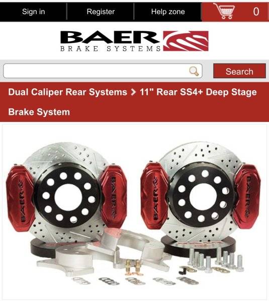

The dual caliper brakes that I posted above are called deep stage, used in high horsepower MoPars.
I didn’t see that as an option for my Charger. Guess I don’t qualify for the high horsepower qualification lol
Your Baer system is all you’ll ever need, what horsepower are you running? What is your caliper piston size?
