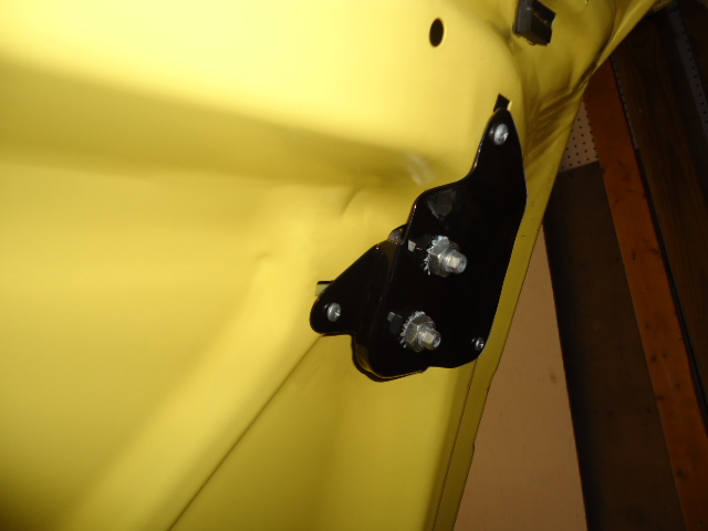

I have an early build 70 RR that didn't have the factory cutouts for the wing mounts under the trrunk lid. I found a Satellite in a boneyard that had the cutouts and had it painted to match my car and mounted the wing on that one. My only regret is not saving the old one, I sold it instead. I suggest get the spare lid fixed and mount your wing on that one when you have the cash, hang your existing lid on the wall. I think the black wing above the black on the tail panel and the black hood stripe will look bitchin'!
Just my two cents, I'm a wing guy. I like them, especially the 71 wing, it's my favorite year for cars. Anyways, having said that, I would still wait and get your other trunk lid fixed and put it on that one.
Thanks Greg, my original lid does not have the factory cutouts and neither does the spare lid that I have. Could you send me a couple of pics of your deck lid showing the cutouts? Then I would have something to go off when I work the other lid into shape.

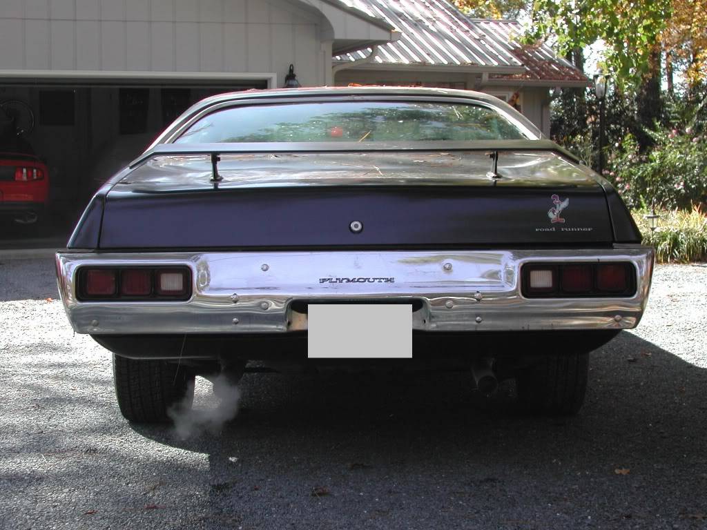

ok...having already gone through you "dilemma"....i say this...ITS YOUR CAR DO WHAT YOU WANT.... with that said....i just put a go wing on my 1970 roadrunner. heres a suggestion. get the under deck brackets that fit into the curved corners. the spread is 36 inches for the go wing. so laying it out on the deck lid and HOPING you hit the correct places is a crap shoot. after you install the brackets...(the holes in the brackets are a PERFECT template).... drill from underneath to the outside. use a small drill bit first then one a little bit bigger than the studs. I WAS SCARED TO DEATH TO DRILL INTO MY ROADRUNNER..... but after it was done..i realized the outcome was worth the strife. just be careful and use sharp drill bits. good luck !
Nice car, love the six pack. I'd like to take the original motor out of my car and put in a stroker with a six pack...someday.
Sure, I'll try and get some pics tomorrow and post'em

Thanks for the info tpod. I'll have to dig my wing kit out again and look at the brackets. It's been a while and I don't remember what it came with, but I think they were a curved bracket....
If that's the case, then no cutouts required?

not sure on your year.
on my 74 the deck lid had the "mounds" where the cutouts go.
I just drilled and put the brackets there without doing a cut out.

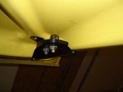

I took some pics of under the deck lid but the bracket covers most of the slots. I dug through the garage and basement, finally found the installation diagram from 1st Place. I'll scan it and PM it to you if I can't get it to load here. In the mean time...
Here is the installation diagram I got with my wing from First Place. The instructions on the back say if you have an early deck lid without the pre-punched slots to drill the four holes for the wing, moun it, and tack weld the reinforcing bracket.
Ok, tried twice, can't attach the .pdf scan of the diagram. Will try and PM it.
