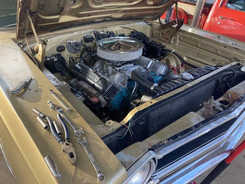

What size are your valves....uh the ones in the heads on the car....One guideline that I heard regarding header selection was to pick a primary tube approximately the size of the exhaust valve.
Many cast iron heads use a 1.74" valve...... 1 3/4" headers are 1.75 and 1 7/8" headers are 1.875.
I went with 2" because they were in stock and because I figured that at almost 500 cubes, it made sense.

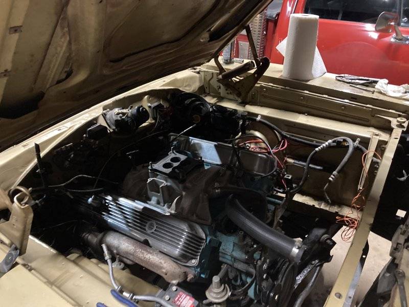

Take pictures! Nothing helps the memory more than seeing it in a picture. Multiple angles with good lighting too.I’m out of gas, so that’s it for tonight. Only thing to do now is remove the z bar. I forgot how all that goes, so I need to do some research, and probably call someone with a better back.
Yep, I’m taking plenty of reference pictures, it should go back together the way it was…with just a few extra boltsTake pictures! Nothing helps the memory more than seeing it in a picture. Multiple angles with good lighting too.
All of my build threads have multiple pictures in my posts. I often go back to reread what I posted to refresh my memory.
