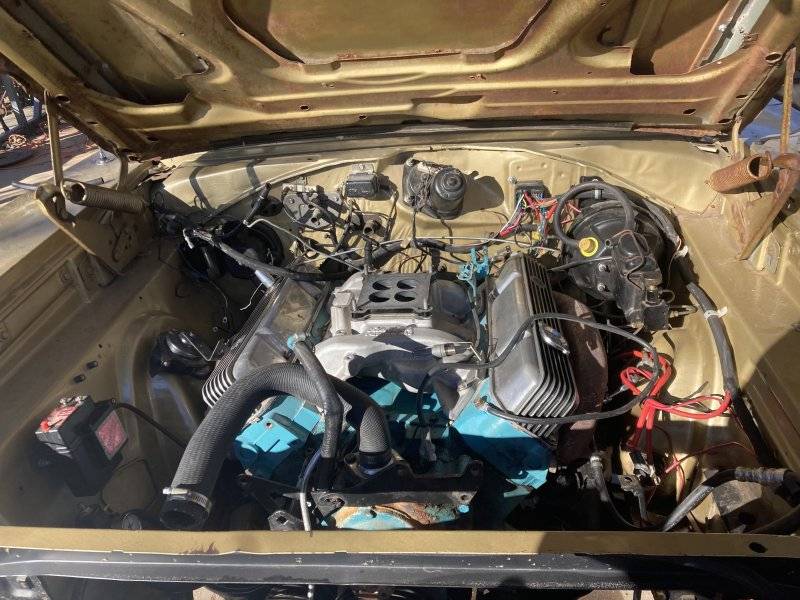

Our Texas weather is like FJB, unpredictable, and confusing as heck. Last two days have been too cold for me to want to work on it. But tomorrow will be warm, followed by crappy weather, followed by a nice weekend. I’ll get back on it tomorrow, and hopefully by the weekend it’s out, and I can get to the fun stuff

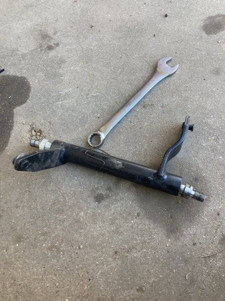

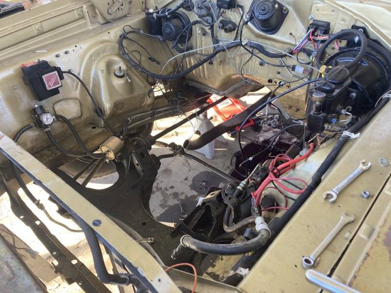

I removed the nut on the frame rail, the clips on the pedal and clutch, and the u shaped cotter pin, and I tried prying with various tools, moving back and forth, all of it, I just couldn’t get enough strength pop it off. So I’m going to try taking off the stud on the bell housing.

There, that’s finally out.

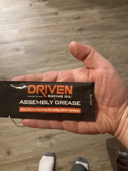

The big question I have is with the came. It came with this package of goop, is this enough goop, or do I need more goop? If I need more goop what’s the best goop?
After reading a few horror stories of cam failures, I want to do everything I can to make sure that doesn’t happen. I’m only changing the cam because I’m a hot rodder, if it works good, it can work better! I’d hate for that to bite me in the butt
Pretty sure that will be good for at least a couple of cams. Assembly lube is available everywhere, many brands.

Yes, that packet will be enough for the cam. You need extreme pressure assembly lube/grease on the cam lobes and downstream parts. So that means especially the cam lobes where they touch the bottom of the lifters. But it is also a good idea to grease the top of the lifters where they touch the push rods, the top of the pushrods where they touch the rockers, and the tips of the rockers where they touch the top of the valves.
Note that I did NOT say the cam journals/ cam bearings interface. This is not a high pressure area. Yes, some regular assembly lube here is fine, but you don't need the extreme pressure stuff there. Buy a good break-in oil for the engine.
When starting the engine, make SURE you have your act together regarding timing and carb setup so it will run decently enough for the break in. Starting an engine with a new cam a bunch of times because timing and/or carb needs adjustments is NOT good!
Once you get it started with the new cam, DO NOT LET THE ENGINE IDLE!!!! Let me say this again DO NOT LET THE ENGINE IDLE!!! Run it between 2000 - 3000 RPM for 20 to 30 minutes. If you let the engine idle before 20-30 minutes the cam lobes don't get enough oil and you can wipe the cam.

Thanks! Your power tour thread is great, hopefully it all goes well for you.
I know about the break in procedure, my neighbors are going to love it! I just wasn’t sure how much goop is needed

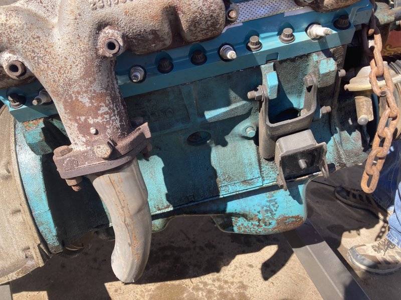

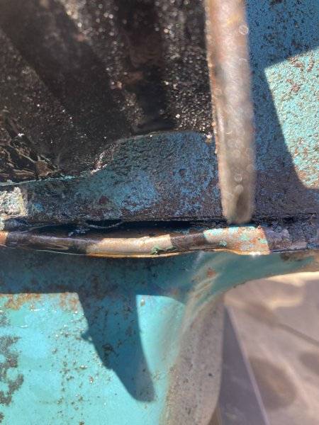

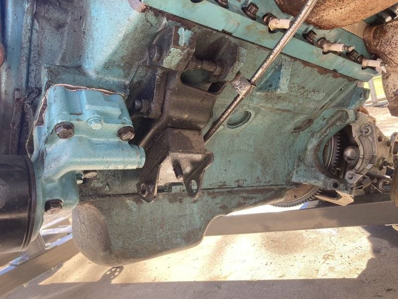

I know the engine was in a low miles 69 Chrysler Newport, the owner passed away, so the family wanted it hauled off. On its journey to the junkyard, Mr tow truck driver didn’t strap it down good and it fell off. The driver side had 2 broken engine mount ears, we welded them back on, and somehow it’s still together!
