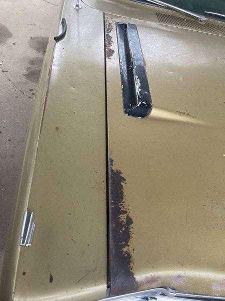

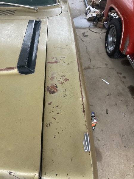

But think about the patina!
Wont somebody think of the patina?!?! :lol:

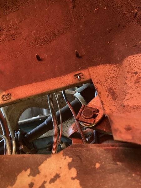

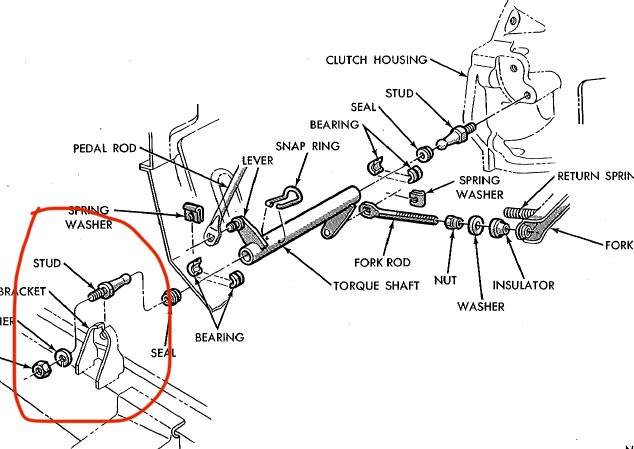

Alright, back it. Taking the nut and various clips off. I’m having problems getting the z bar off though, I can’t work with my hands above my head for very long.

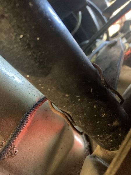

First picture. That wire clip fits down into the bushing inside the tube. Pull the clip/s out. Then pull the outside ball into it and should be able to get it out.

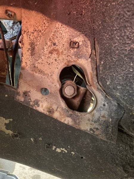

Ok, so it looks like to get the z bar out, I just undo the nut at the frame rail, a clip, and it comes off. Looking at the diagram, I do vaguely remember that when I put it all together. I’ll find out tomorrow
Yup. Factory service manual sure is a handy thing sometimes...

Yes, I have all the clips, the problem I’m having is the pulling part because of my back.
My new plan is to unbolt the stud from the block, hopefully that works

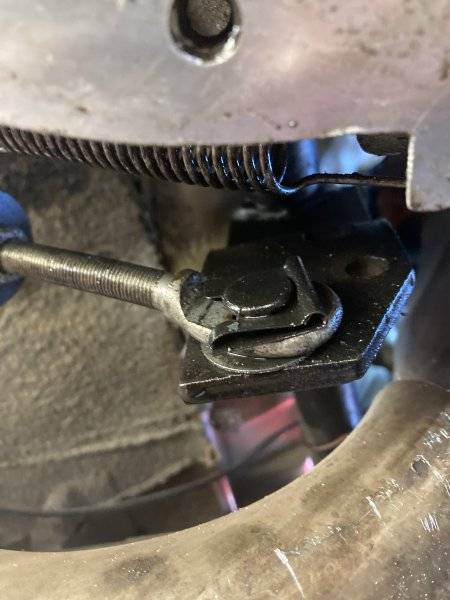

Oh - you might find the other ball for the z-bar on the bellhousing, actually. :)
Seriously though, if you pull the "cotter" u-shaped pin thingy like others have said and then grab the bar with
something like a pair of vice grips and try to move it laterally back and forth, you'll find it plops right off the
bellhousing pivot ball (if you have the other end unbolted and lifted up off the frame mount, that is).

Yep, I have 5 of them pinching nerves, neck, mid back, and base, and they cause all kinds of problems. I have very weak hands, and it’s hard to do things above my head. Makes my hobby I enjoy so much very difficult.
I removed the nut on the frame rail, the clips on the pedal and clutch, and the u shaped cotter pin, and I tried prying with various tools, moving back and forth, all of it, I just couldn’t get enough strength pop it off. So I’m going to try taking off the stud on the bell housing.

Did you take the z-bar end at the frame actually up off the bracket welded to the frame?
Loosen that nut substantially (but don't take it all the way off, you don't need to), then pick the whole
arm up out of the bracket - it'll pop up. Get it clear of the bracket/frame...
That will release the tension and the other end at the bellhousing should come right to you at that point.
I actually took the nut completely off, I tried picking the bar up like that, but I was a little worried about breaking something
