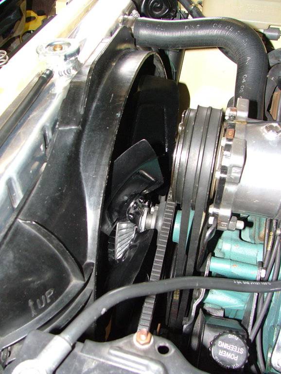

Bill what size radiator do you have? I bought a oem repop from Mega parts for a Griffin exact fit radiator. Fit pretty good. Couldn't flaw the shroud as I think the radiator brackets were just a smidge different but overall I was happy.
Thats not a fan shroud. It's a fan guard. Only good to keep your hands out of the fan. You need a shroud that covers the whole core, with the fan set 1/2 way in the shroud.

I also agree, use the stock or repro stock type that will work with the fan diameter.

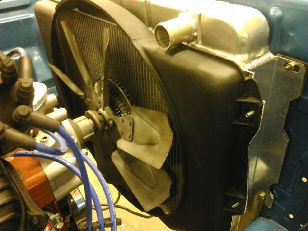

I need to measure my Champion radiator shroud mounting holes and make a drawing and see if someone can help me verify a repo factory shroud will fit.
I have a stock 26 inch shroud on my Sport Fury. Tell me what measurements you need, and I can measure when I get home. Just so you know, i doubt anything will just bolt up. Probably have to make brackets.
I put a Mishimoto(?) 26" from Summit last summer in my '68 and used my oem shroud picked up yrs ago along with the oem rad. that finally took a dump. Used their mounting holes & redrilled the shroud to match. Classic & most only sell 22" shrouds(?).
And I hear a groundswell of support for someone to make a 26" shroud that works like the 22". If you don't have room to go thicker on the core at least you can go 4" wider on same core width.
