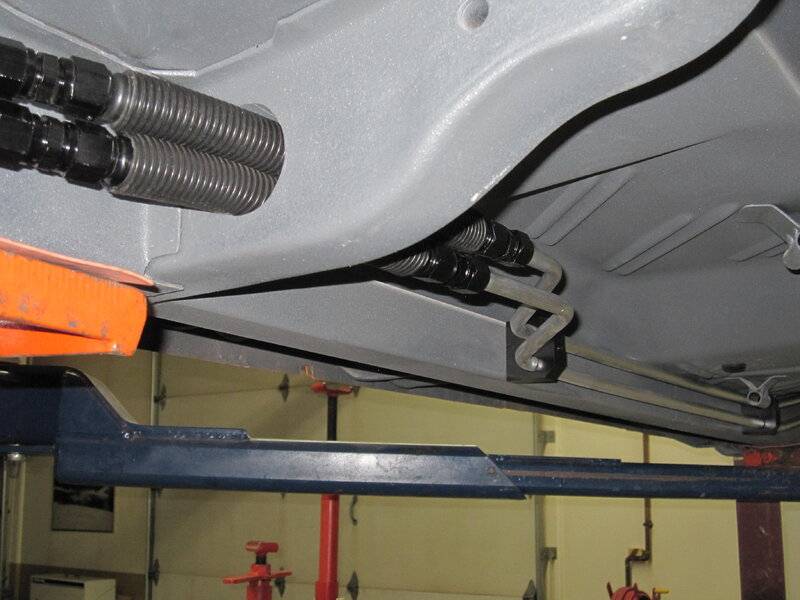

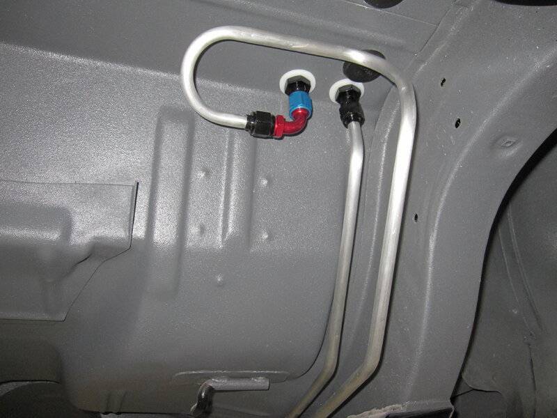

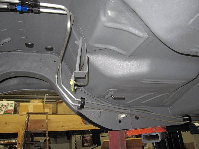

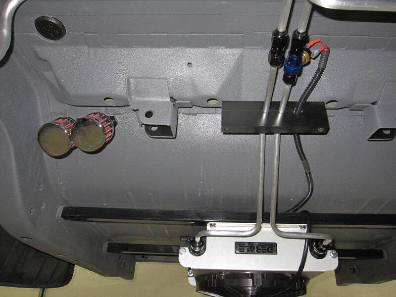

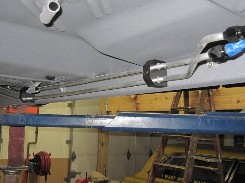

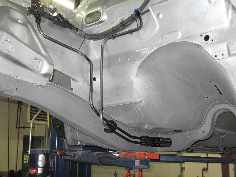

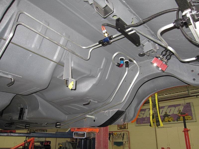

This is my 65 Belvedere. Fuel and trans cooler lines.
Mike
Mike
The clamping blocks are made of phenolic resin, painted. The material is easy to work with and machines nicely.Did you mill those billet blocks? Looks AMAZING!!
1. I used rubber fuel line and slid a piece of split wire loom on for abrasion resistance. The holes are where I cut out the T-bar anchors and welded in sleeves.looks great ! 2 questions
1. as the fule line goes threw the crossmember? What is that? some sort of sleeve or is it a flex line of some sort?
2. what are the dual filters for at the back
