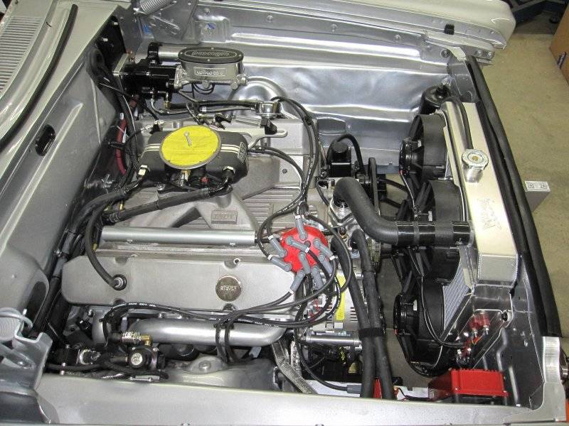

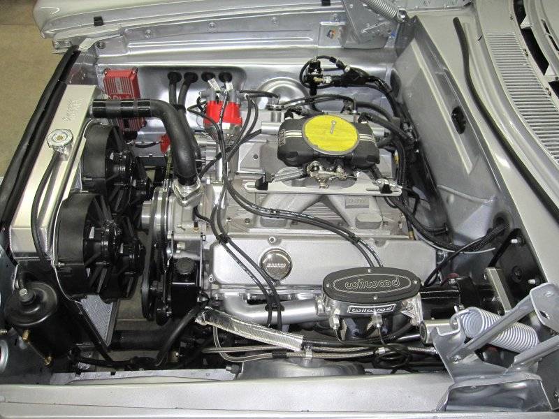

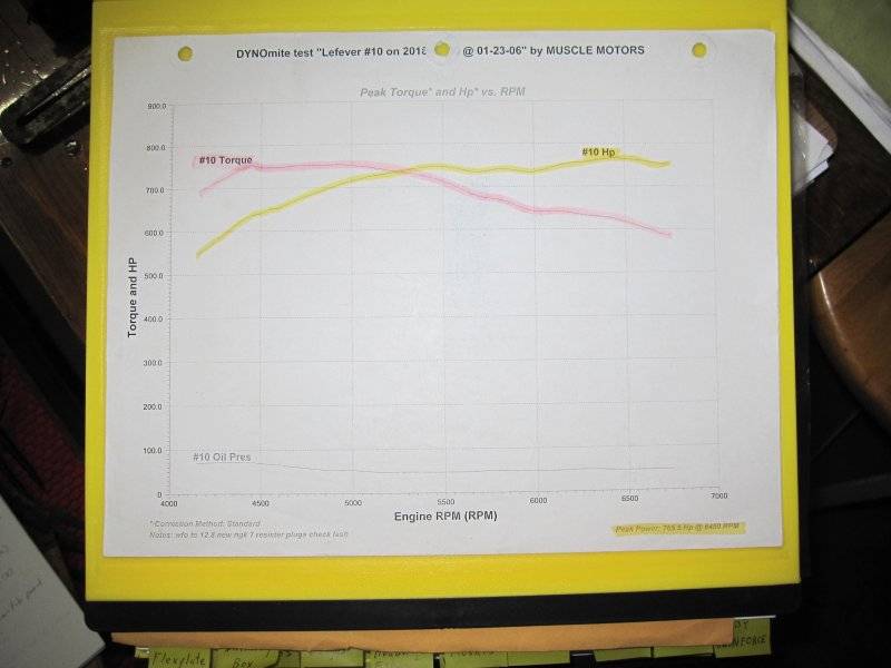

I believe I have finished the engine install in my 65 Belvedere. This is the 540 Indy I had Muscle Motors build for me. Picked it up in 2016 and will fire it this summer. It was dynoed before I brought it home. It weighs 420# complete! I think it looks pretty good but, I'm biased.

Indy Maxx aluminum block

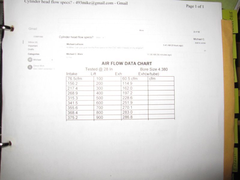

Indy 440-1 CNC'd heads
Molnar crank and rods-7.1" C-C
Comp Cams custom grind solid roller
Isky bushed solid roller tappets
CR= 12:1
T&D 1.6:1 roller rocker assys.
TTI 2x2 1/8 headers
Complete MSD ignition system (advance controlled by FAST 2.0 F.I.
All ARP hardware
