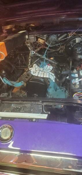

Pictures of what you're dealing with?
Yeah, I think pics might help. I've done swaps with ceiling hoists, engine hoists,and body drop methods. So, I'm not sure what you mean by "too short".
The boom doesn't extend far enough. I think I took a picture. The engine is out, it's a matter of getting back in.
It's difficult to see what you're up against. You can use a load-leveler to adjust the angle. Or mount the chain fore-and-aft, adjust the pickup point on the chain for a good angle to drop it in. I'm puzzled, if you got it out, why can't it go back in ? Post #5 may help, as well.
The picker is not too short. The boom is normally adjustable for length/height. You just need to get it in the proper place. I hope you are not installing it like in the picture with the heads off and everything exposed.
You don't really specify what the exact problem is. It won't go back in ?? You can't get the engine high enough to clear the radiator support or you can't lower the engine down enough to disconnect the chain ?
You do have a conventional K member on a 72 and if you need to lower the car you can simply loosen the torsion bars and put a floor jack under the k-frame. Then you can lift the front end with the jack to help align the engine/mounts.

Buy the load lifter. It will shift the engine back a whole bunch. Also shorten the chains don't bolt them up to the end loop so the load lifter is tight against the engine. Shorten the chain on the lift hook as well so your center of gravity is not as high on the hoist.
