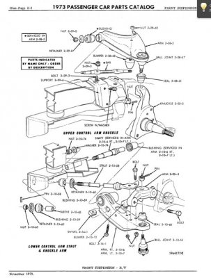

The 3rd gen chargers can further be divided into 71-72 & 73-74 in the respect to extream differences in suspension. 73-74 introduces the ISO (isolated) rear axle from leaf springs, K member from unibody and torsion bar cross member... all by rubber bushings.
To get a little more specific to the question you ask about the front suspension;
73 and up K-frames are isolated from the unibody and the K frame also supports the upper control arms (not attached to the unibody)
As mentioned, the upper control arm assemblies for 73 and up B, F, M, J and R are (to the best of my knowledge) are interchangeable as an assembly (bushing sizes did change in 82). These upper controll arm components definately CANNOT be used for 72 and previous however...
The spindles on all the 73 and up B, F, M, J and R are also identicle and do differ in hight by about 3/8" and there are slight changes in geometry as well compaired to the A & E spindles. This is the root of the debate as to whether these should or shouldnt be used. From my research and reading the debates I lean towards using these is not a problem.
To do this swap you will need to change out the MC and prop valve for the disk brake set-up and get the proper flex lines. And of course the disks, pads, rotors, etc
Hope this helps
