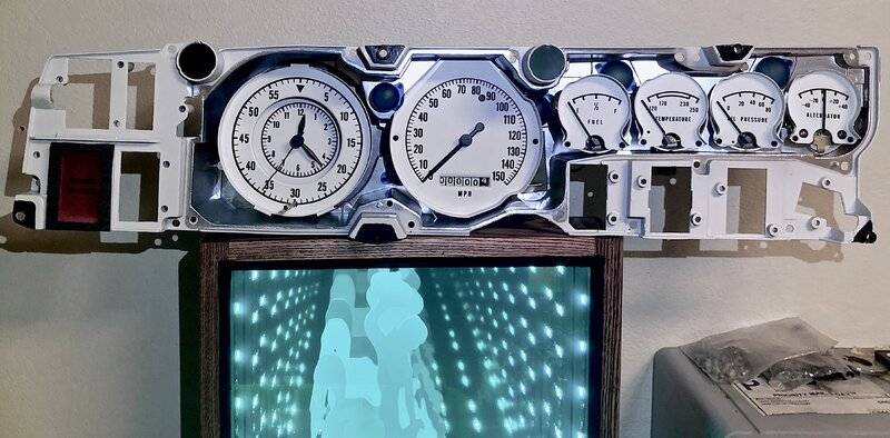

has anyone put white background on their rally gauges?

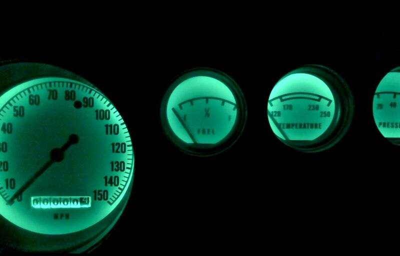

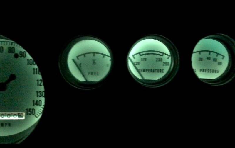

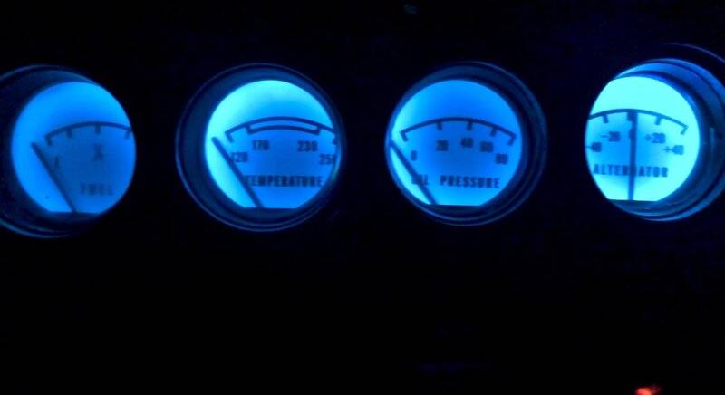

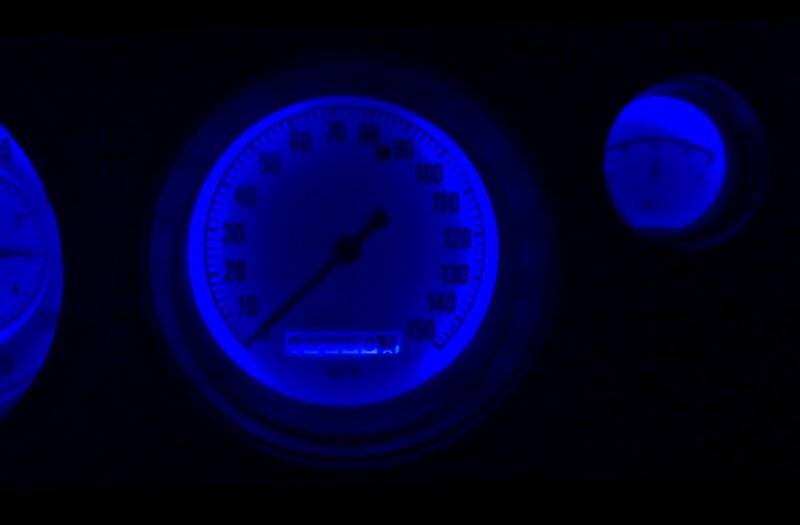

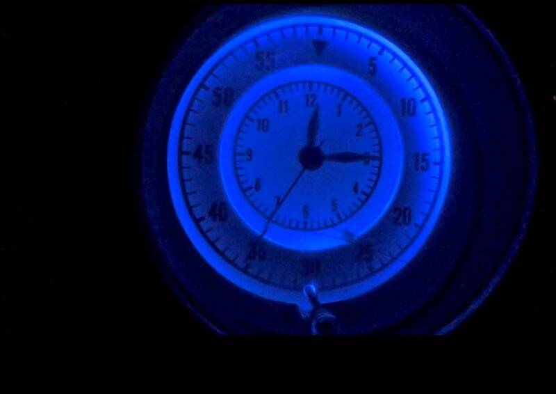

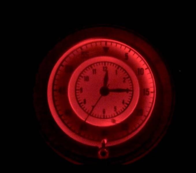

Yes, I am a believer in white faced gauges now! They look fantastic with dimmable led RGB lights. The pics are a bit fuzzy because they were captured off my video. The "glow" looks amazing and I can change it to any color. I have been working on this LED project for over a year and experimenting with all types of products and finally identified what is needed and how to do it. Anyone reading this may know that I specialize in restoring 68-70 B body Rallye Gauge clusters and bezels. Please pm me with questions/comments. Thanks, Steve
fullsizeoutput_66e.jpeg fullsizeoutput_688.jpeg fullsizeoutput_68a.jpeg fullsizeoutput_686.jpeg fullsizeoutput_685.jpeg fullsizeoutput_684.jpeg fullsizeoutput_68b.jpeg fullsizeoutput_66e.jpeg
That looks very nice. I'm doing my panel with a long ribbon of RGB lights tucked in there, controllable with a remote control but I left my faces black.

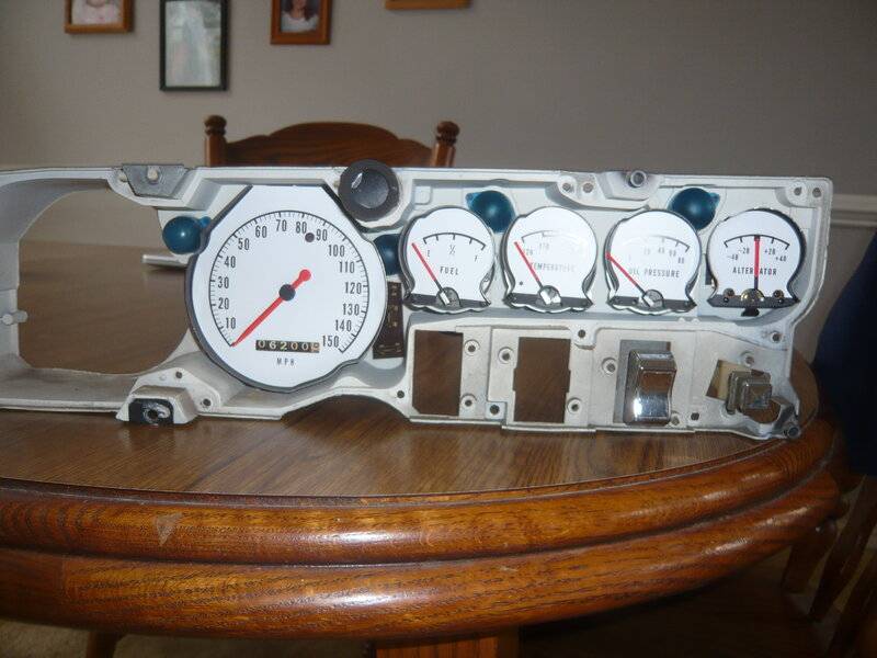

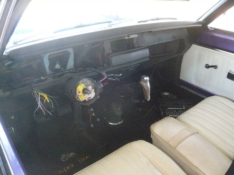

started taking the dash apart today

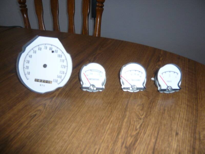

what we could get done today,had to order a new alternator gauge and figure out how to take apart the tic toc tach
FYI only need to go to step 4 to install decals 1)Disassemble Cluster and remove the Tic Toc Tach clock/tach unit 2)Remove the clock hands using the following technique with a pair of scissors FIGURE 2 – Showing Technique to safely remove clock hands. 3)Separate clock unit from tach section by undoing two tiny screws on the underside of the clock and a third screw that holds the clock to the tach housing body. 4)Using a screwdriver remove brass contact from clock electrical terminal so that it will be able to slide though the hole in the housing after the grommet has been pushed out.
Thank you Photon440 you are a lifesaver.
