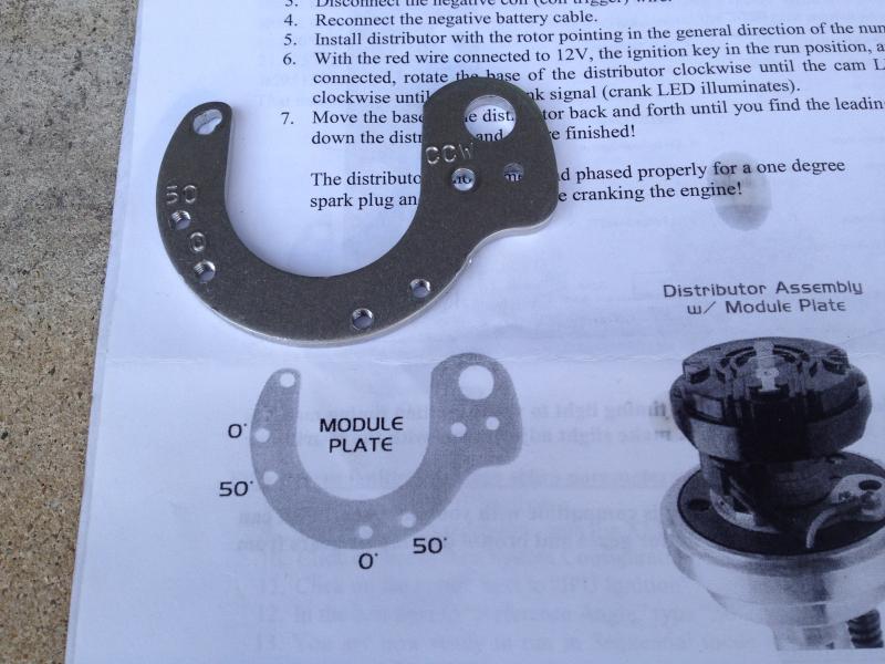

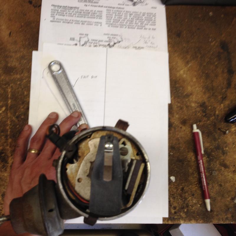

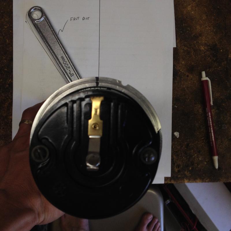

So I have been struggling with the timing on my car. I can get it to run, and even run somewhat OK, but I can't get the computer to know what the timing is set at, and my timing mark on my balancer is no where near where it should be. Part of my problem is that I only have a basic timing light, so I can't dial in an advance on it to see where it really is.
I am wondering about the FAST distributor. A number of things just don't add up between the documentation and the part. Here is my first issue. The distributor allows for the module that senses rotor position to be mounted in a 0* or 50* position. However, the instructions (that are supposedly specific to my big block Mopar), have the opposite notation for the 0* and 50* positions. Now we all know that like it or not the world revolves around Chevy, and that distributor rotates clockwise while a Mopar B engine rotates counter clockwise. So I am inclined to believe the metal part markings since it has a "CCW" marking on it. But if that is wrong in the instructions, then what else is wrong? When I rotate the distributor base to get the LEDs to light as per the instructions, the #1 ends up way retarded from TDC. I that right? It sure doesn't seem so because I may have even backfired and destroyed my one muffler.
The next issue is that according to the FAST instructions "the rotor is pre-phased from the factory at 30* BTDC". Now I know my pictures below are hardly precise, but I will certainly argue that it is NOT 30* BTDC. If anything, it is further retarded than a standard Mopar distributor. I took these by using my adjustable to "index" the slot at the bottom of the shaft. Is this another issue with clockwise vs. counter clockwise? I am also not convinced that the electronics module is mounted correctly either. Is there another issue with clockwise vs. counter clockwise? I need to talk to FAST techs and see if I can figure out what is going on...
