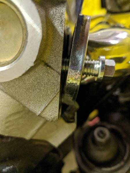

Checked my engine position against the TTI website specs (http://www.ttiexhaust.com/Footnotes/FN_39.htm), while mine sits a little high (guessing since there is less weight on motor mounts right now) it seems to be roughly correct. For 68 b-body with RB, they spec center of crank to K-frame as 5-1/4", I'm sitting a little over a 1/4" higher which I think is working in my favor. Side to side they spec as 1-1/4", where as I am 1-1/8". That 1/8" difference side to side is closer to the drivers side, but my K-frame is probably off that much, and moving that won't help clearing the power steering pump since its attached to the K-frame not the body. I haven't tried loosening the power steering pump and trying to move it.
I also have a set of factory heads that I compared the exhaust "face" angle relative to the block face and the stealth heads are a perfect match. I just don't think the damn things fit. Looking at the #3 tube, it looks to me that it should have been bent at a tighter radius and then maybe I could get by with a minor whack. But as it stands my back of the napkin math looks like I'd have to beat it half closed to make up the angle from top to bottom on the flange.

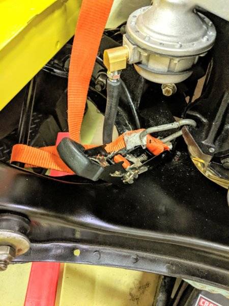

Took Mike's advice and used a ratchet strap to the strut to pull the engine over to the passenger side while putting in the driver side mount bolt, which is actually a handy trick for getting the bolt in easily. That moved it over to the factory spec.

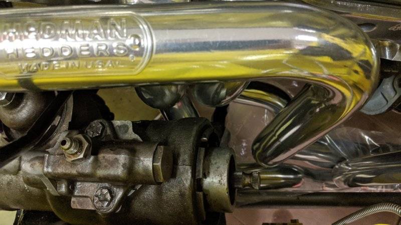

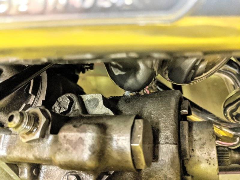

That plus filing the bump off the power steering box seems to have gotten it down to where I think about a 1/4" indentation will buy me about 1/8" of clearance. This is what it looks like with the pipe up against the steering box:
There's only about 50 thousandths difference between top and bottom of the flange now. While it's disappointing to have to take a hammer to it, my budget (and spending clearance from the wife) is such that I'm motivated to make these work. Going to take it up with Hedman just in case, but if they don't think there's an issue with the one I have then I guess it's whacking it with a fat wooden dowel / big f'ing hammer.

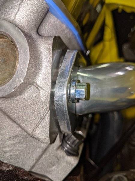

Well, contacted Hedman and they actually sent me a new version of the drivers side header, and it does fit a lot better. Barely contacting the torsion bar (1.03s) but I don't think it will take much to get a little clearance. Still need to check spark plug clearance and mini starter. If you are considering the Hedman headers, I would suggest verifying that they are the new version (they are actually stamped 78536). As always, thanks for everyones help. Next step, just ordered "Summit Racing SUM-680141 - Summit Racing® Header-Back Dual Exhaust Systems", will report back how that goes.
