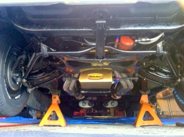

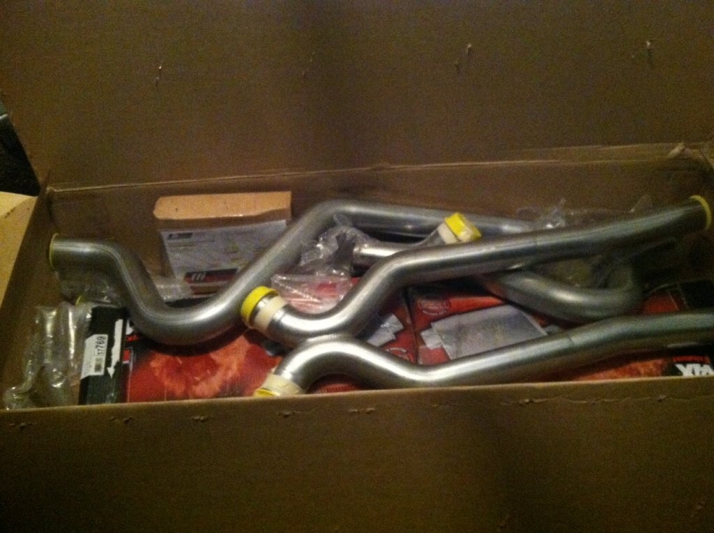

Hi Gary, I run the Eddy RPM heads on my 440/493. TTI 440-200. There 2" primary 3 1/2" collector no fitment issues great header. If your running and automatic with kickdown linkage you have to modify the lower bell crank and rod no biggie , and if your running a console shifter you need to cut and reweld the tourqe shaft bracket. best headers out there for Mopar in my opinion. I'm also running 3" x-pipe TTI exhaust to the bumper. Good Luck

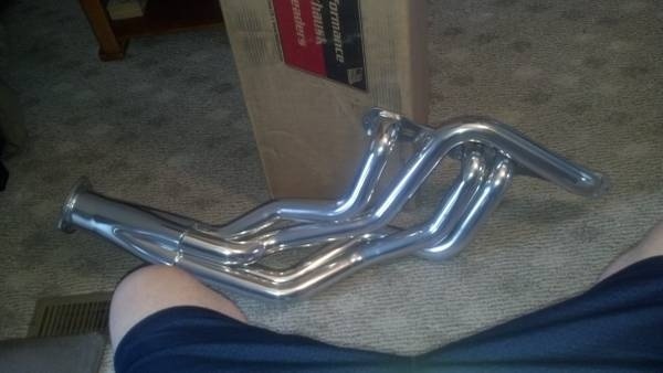

It is my understanding that Summit brand headers (Patriot) work well with angle plug heads on B-bodies. If money is an option they can be bought with ceramic coating for $392.00 shipping included. They are 1 7/8 primary tubes.
Yes! I bought the Jegs brand (They are Patriot's) ceramic coated headers for about $350. Assembled in Mexico! They fit nicely, and I only had to make a small dent in the #2 pipe so that the #4 plug boot would clear it better. I also used Accel 414S shorty spark plugs on 2, 4 and 6 cyls for additional clearance.

The Jegs/Patriots worked great! I only had to dimple in the #2 ex pipe to give more clearance for the #4 spark plug boot. They are holding up just fine. It sits in the garage most of the time, we've only taken it to the track once this year so far. I put the same header on my other RR, and they never leaked or cracked. And I drove it around alot more than I have this one.

I have the Summit brand headers (made by Patriot) and Trick Flow heads. You’ll need to dimple the #2 & #8 tubes for clearance. All others have plenty of room.
