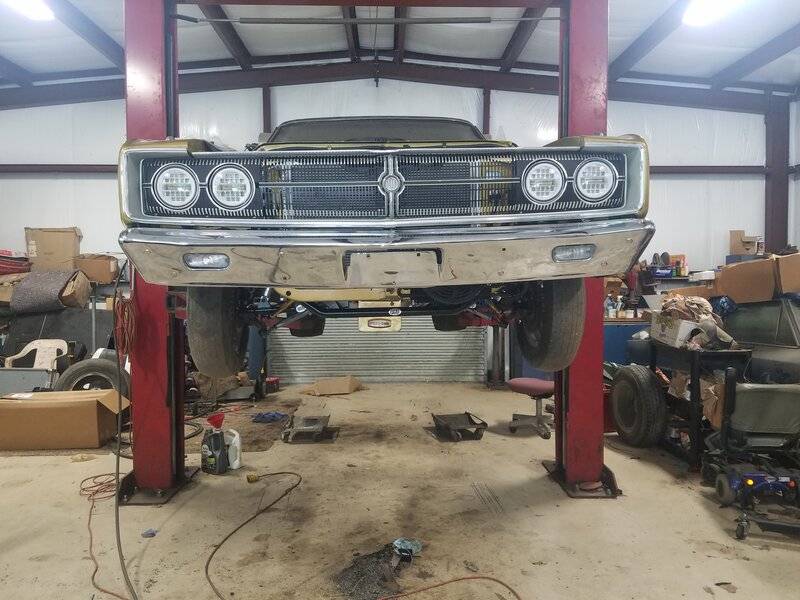

I suvked it up and bought some that were a lot better quality and come with a heftier price tag. They are pretty but not for a purist. I also had to cut out the back of the cup to make clearance for the large heat sinks.
