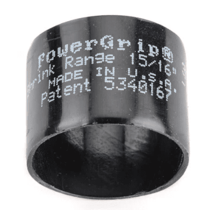

the rep i talked to called it a heat shrink wrap so did some digging and still have not found the true name but i will. but in the meantime also found they are now making water hose clamps that you heat up and they shrink to size.

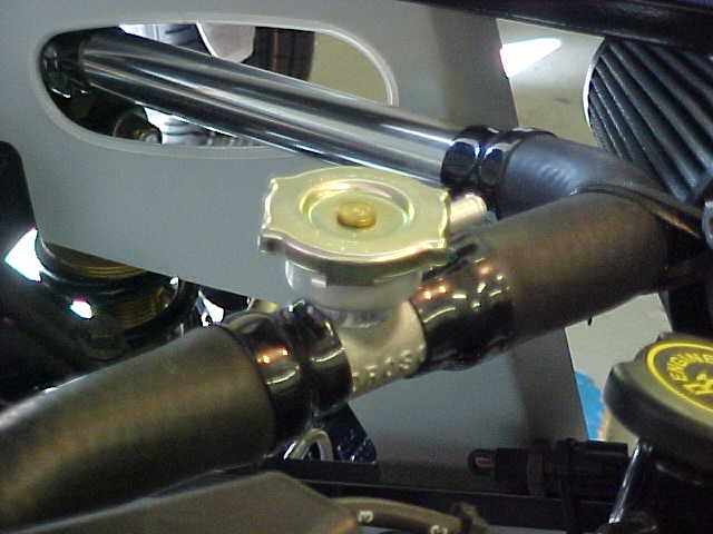

Water hose heat shrink is way thicker. It does work great.
i understand its thicker just finding it interesting that this high tech comes in so many different ways today.
Gates makes heat shrink tube for radiator hoses, something smaller would probably work on a/c fittings. It seems to hold pressure.
