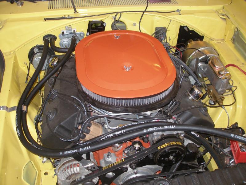

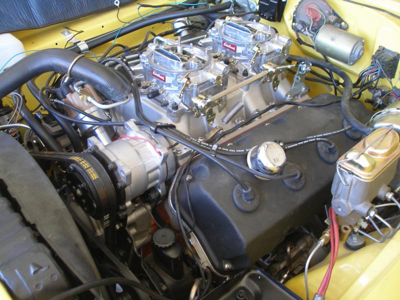

I put a set-up on my 70 Superbee
I purchased a kit for Master Power (?) Brakes I think.
Yes: everything WAS inclusive.
BUT: They provide you with a GM Style Brake Booster set-up.
Sure, you have to route and bend your own brake lines to the Master Cylinder and hook up to the Proportioning Valve etc.
1/2 Afternoon setting it up etc.
I hope the PICS help
Yes: The True Mopar Bendix Style from Ram Man (Texas) and some other company I cant remember the name are BLACK in color
IF I ever do it again, I'll get a Ram Man booster (Original Bendix type) or this other company (cheaper) but the Same Bendix style

I don't see why not. Maybe some of the brake experts can chime in. Power front disc (even stock) is pretty good in my opinion + you already have upgraded calipers. As you know, the 4 drum manual systems take about a mile to slow down.
When you upgrade your brakes upgrade your master as well. Power vs manual brakes. Personally I prefer a 4 wheel manual disc brake set up. Brakes the same as power brakes but you know your pedal feel and know it'll always stop. And you don't have that ugly booster in your engine bay. Your mistake was that you slapped a performance front disc brake kit and changed nothing else.
I upgraded my front drums to power as well. I also upgraded the master cylinder the same time with a power booster. My set up looks similar to the pic above from the bee. I can't imagine you putting the front discs on and getting anything significant with the stock master cylinder. I'd be afraid to drive the car that way. I'm not even super happy with my set up with all the goodies attached. Just okay.
