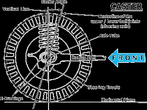

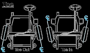

Castor... toe .....camber Sound like you have to much toe in......... Take a look at these links they are helpful......
Caster is the fore or aft slope of the steering axis. The steering axis is a line drawn through the upper and lower ball joints of the knuckle. Positive caster is when the bottom of the steering axis line is in front of the tire's contact patch. Zero caster is when the steering axis is at 0 degrees. Factory alignment specs for basically all vehicles call for a certain degree of positive (shown) caster. This ensures good stability, helps maintain straight-ahead direction and promotes steering wheel self-centering.
Toe is the side-to-side difference in distance between the front and rear of the front tires. If the distance is closer at the front, it's called toe-in. If the difference is closer at the rear, it's called toe-out.
