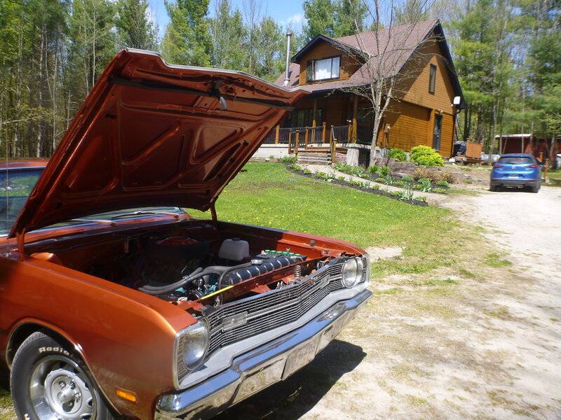

'69 Dart's came with green cap batteries..
