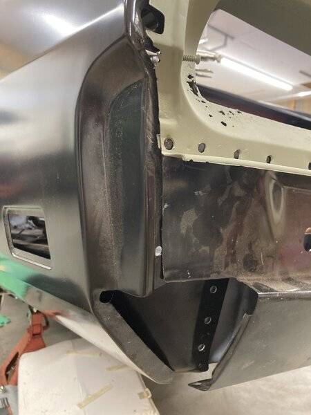

Hi everyone- is this correct?? Does the rear valance install outside the quarter panels, or does it tuck behind the quarters?
Thanks- I’m mocking things up.
A good second gen Charger (68-70) guy will know. I do know there is a sequence to follow when putting the rear sheet metal together on one. That is a second gen Charger correct?
The way you have it is correct. But defiantly watch Cris's video it helped me. As I am doing this to mine right now.
