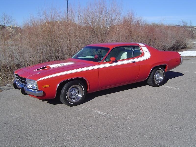

I'm running 235 60 15 on the front and 255 60 15 on the rear, my wheels are 15x8 with 4.5 inch back space.
Here is how she looks.
