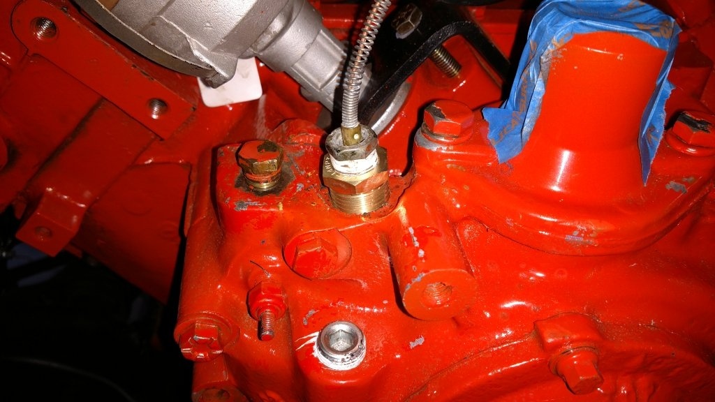

The mechanical bourdon tube needs an adapter with a seat for the sensor. You can buy it from Summit or Jegs. Autometer, SW and others all use a similar adapter. If the large hole is 1/2"NPT, you'll also need a 3/8" to 1/2'" bushing. The lower hole can be used for your future heater hose fitting, and the 1/4"NPT hole will need a 1/4"NPT to 5/8" hose fitting. Again, Summit or Jegs has those. NAPA probably does as well.
Thanks Dave! Yeah, I did a little research this afternoon at the local big box auto parts store. I had a new Bosch kit open on their countertop and wala, there were the needed fittings.
Wasn't about to pay $25.00 for the gauge kit to get them, though. :)
I'm still wondering though - why did Mopar make the upper left hose outlet 1/4"?
Were they trying to throttle down water flow through the heater core?

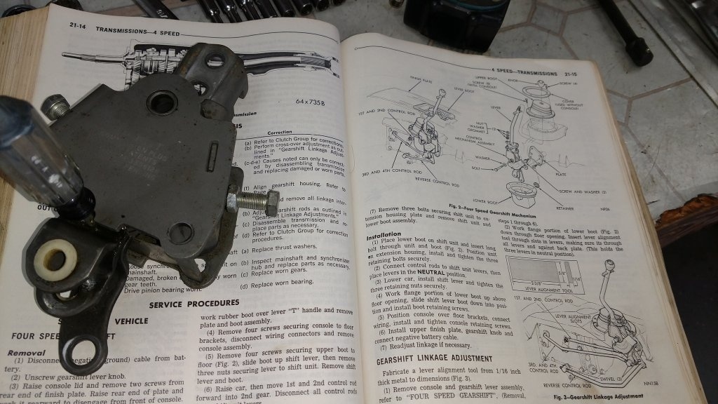

and
the freshly cleaned out shifter and factory shop manual. Notice I have the shifter lined up in neutral, little screwdriver holding it there.

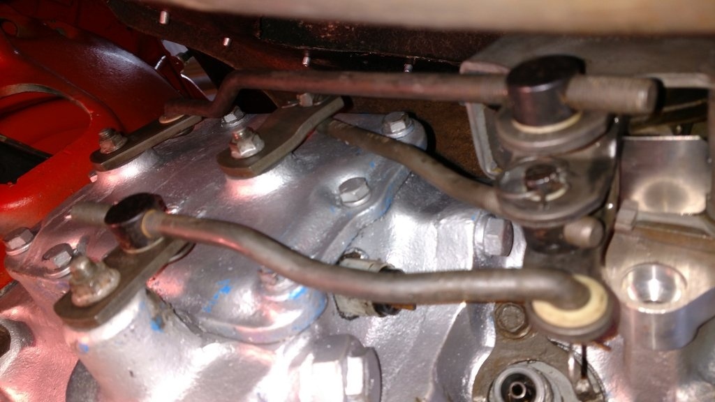

Finally got things to this point:
Something was bugging me about the reverse link, though (bottom one in this pic).
Anyone else spot it yet?

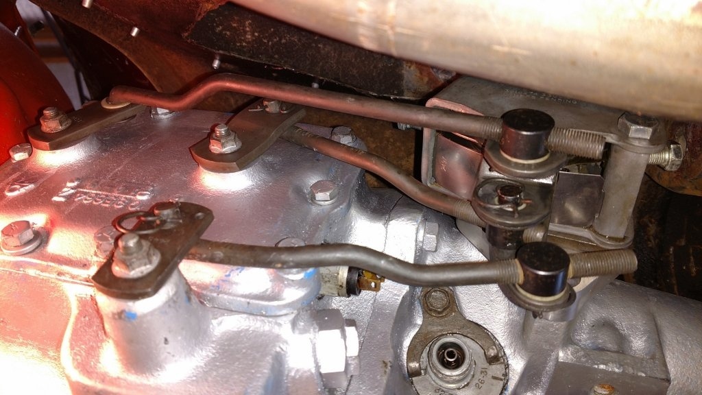

Lots of re-checking of documents, followed by a feverish search online, yielded little help - until I looked again at the pics Dan Brewer sent me.
Eureka!
Let's try this again:
Yeah, that's better. :)

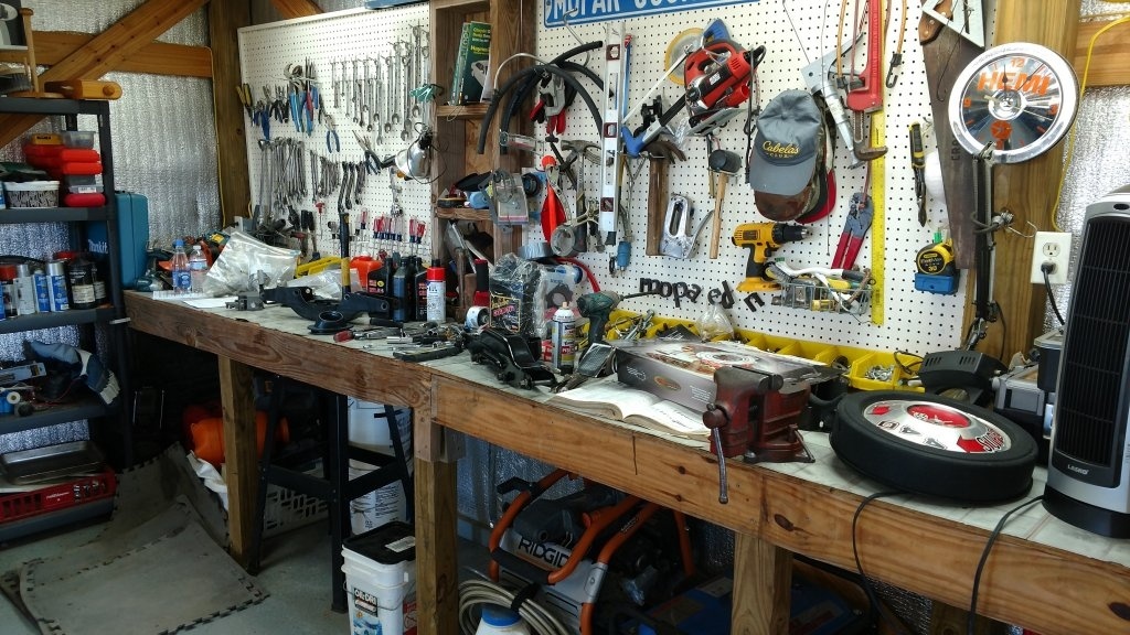

Work benches are shelves they collect stuff?
I've worked for years to improve my cleanup after EVERY project. Some success but have relapses.
I wish my work bench was as clean as yours. I'm horrible at putting things up. I know exactly where things are in the clutter. I have to clean up to work on things.
Oh, I've become much better at cleaning up each time over the last few years, mostly because I'm finally acknowledging that I forget stuff so easily. :)

I don't remember now, why the Hurst shift linkage was such a PITA. They can be installed several different ways, and I had little, if any, instructions and photos. Reverse rod and ends, was the nasty one.........................MO
I couldn't find anything on which way the reverse lever on the trans was supposed to go back on (this one is offset on the rod end). No pic I found showed an offset lever; they were all centered.
I knew something was wrong the first time by the way the snap ring was hanging off of it and how hard it was to install. I finally let the rod tell me how it should go and it did. :)
