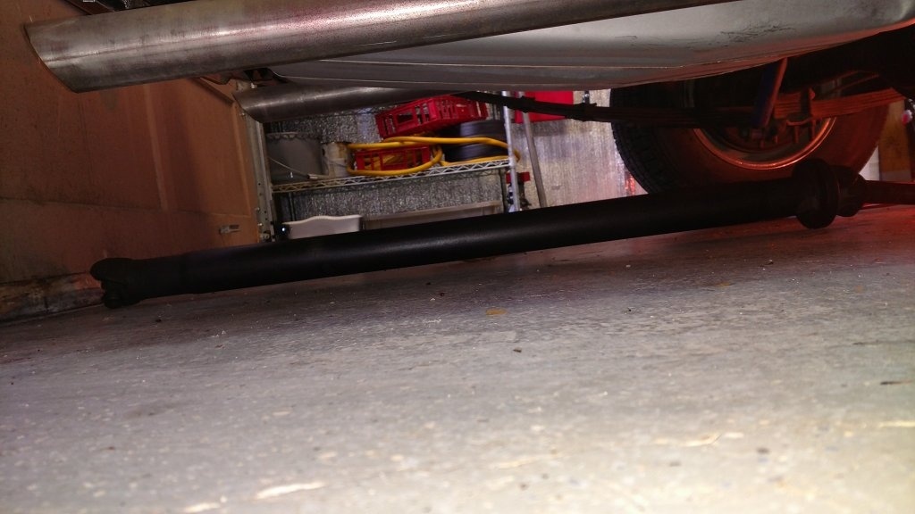

Factory service manual at the ready, I first dropped the driveshaft and removed the shifter, then disconnected the speedo cable and reverse light wiring.

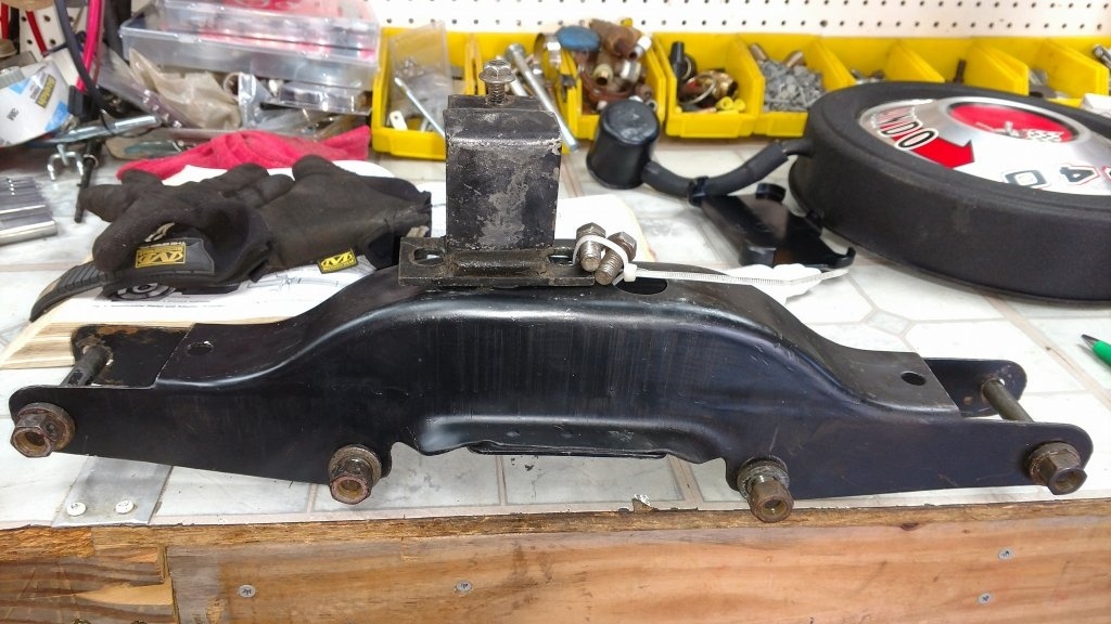

Rear of engine supported, I then removed the transmission mount and crossmember....
...which came out clean and easy.

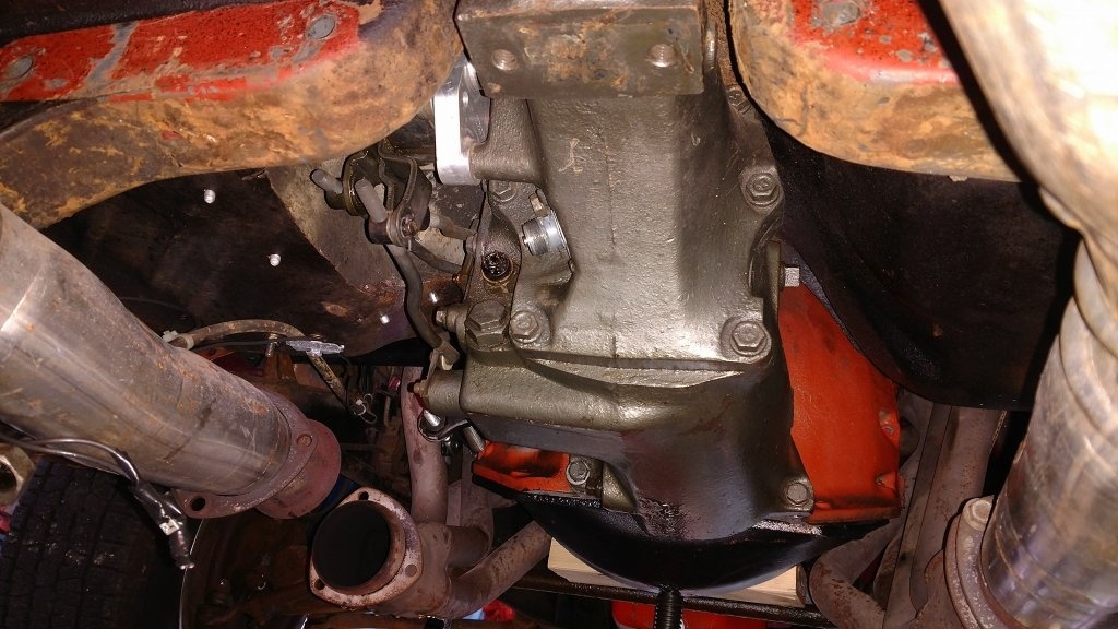

The first sign of trouble was when I decided to get the top drivers' side transmission to bellhousing bolt out while I was over on that side.
Well, not so much - that bolt is pretty much inaccessible with the engine/tranny in their approximate "normal" position.
I decided to drop the temporary engine support down as far as I could without taking risks, thus allowing the rear of the transmission to droop quite a bit.
The top left mounting bolt was still a biyotch, but I finally got it out of there.
At that point, I knew I could do everything else from the passenger side, so the new tranny jack went under and I went for it while I still had any gas left in my tank.
It became obvious in a hurry once I got that jack under there that there was no way it, with the transmission perched on it, was ever going to come out from under the car - the car simply wasn't high enough off the floor for clearance, nor was it going to be - the jackstands were as high as they could go already.

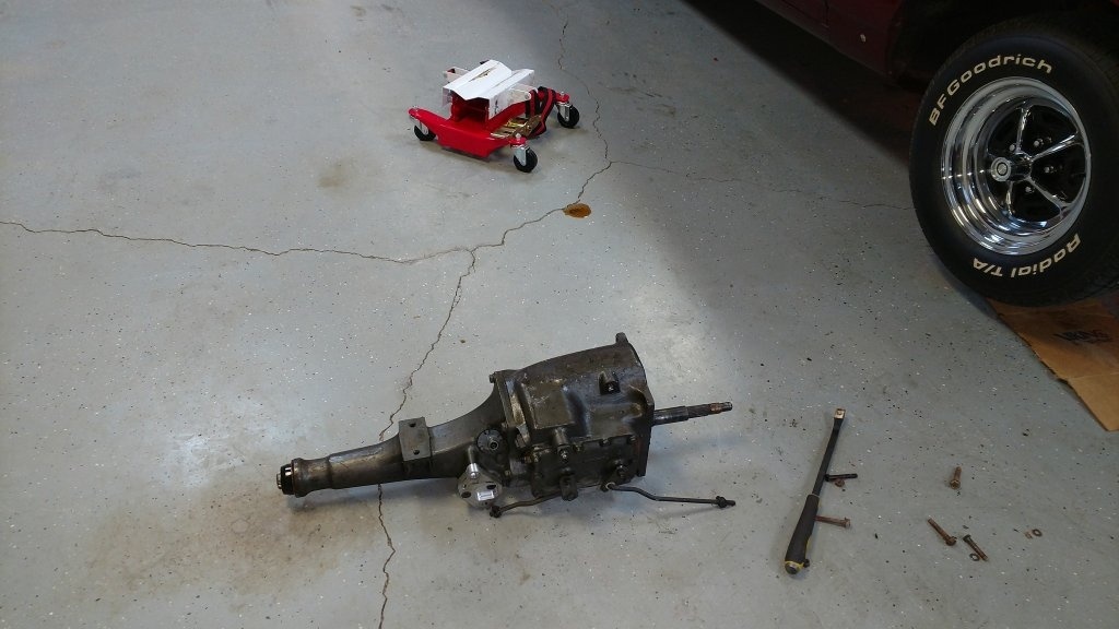

The new, shiny tranny jack went under and supported the transmission. I pulled the other 3 mounting bolts from tranny to bellhousing, then started the fine wrestling match of getting the transmission out of the back of the bellhousing.
Once that was accomplished, it was time to get it out from under the car.
I had two choices:
1. Yank the transmission off the jack and simply let it hit the floor
2. Ed becomes the de facto trans jack
I chose option 2:
Jack is fine. Car is none the worse for wear. Transmission got a nice ride on me and even has the bushing on the input shaft for some reason.

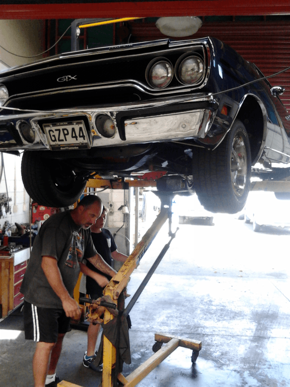

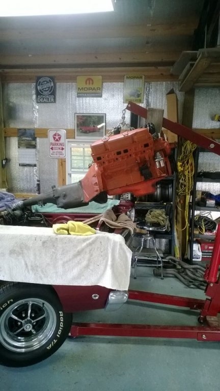

Been there, too:

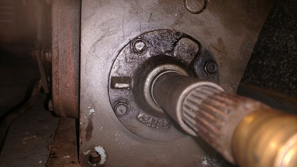

This old transmission input housing has part number C94796.
That's the smaller 4.354" outside diameter/3.70" bolt circle, originally installed in 64-67 b-bodies, 64-75 a-bodies and 70-up small block e-bodies.
It's the WRONG DAMN TRANSMISSION!
Man, I hope to heck the hole in the bellhousing is bigger than that so I can replace this thing with a proper big block transmission!
I'll get under there and measure it tomorrow....
dammit.
There is hope, though. It looks like there's an imprint of the bellhousing hole on the front of this transmission and it sure looks bigger if that's what I'm seeing.
