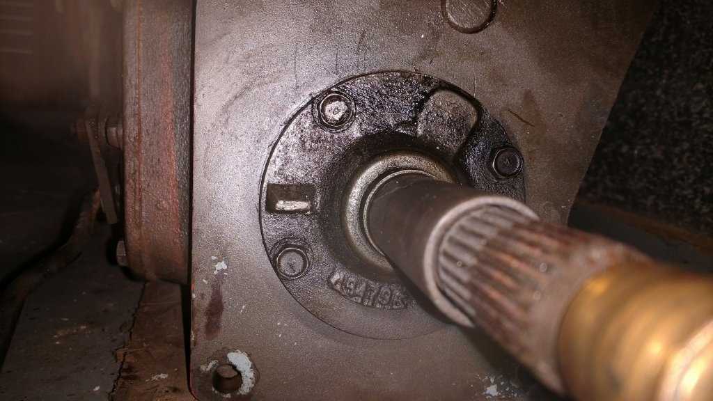

This old transmission input housing has part number C94796.
That's the smaller 4.354" outside diameter/3.70" bolt circle, originally installed in 64-67 b-bodies, 64-75 a-bodies and 70-up small block e-bodies.
It's the WRONG DAMN TRANSMISSION!
Man, I hope to heck the hole in the bellhousing is bigger than that so I can replace this thing with a proper big block transmission!
I'll get under there and measure it tomorrow....
dammit.
There is hope, though. It looks like there's an imprint of the bellhousing hole on the front of this transmission and it sure looks bigger if that's what I'm seeing.
I don't know if this is your situation , but Brewers has a metal ring that goes around the outside of the bearing retainer ( input housing?) and adapts to fit the bellhouse hole that is slightly larger diameter. I am using that and it works great..Not sure on the years without looking at Brewers website catalog..............MO
That would make sense.
Apparently, though, it's sometimes not needed - lookit my situation, for example.
It appears the four mounting bolts located the transmission close enough to centered in the bellhousing for it all to work.
I'm still shaking my head over that. Apparently I didn't just have a mystery motor, but a mystery transmission as well!
It's all moot anyways. This transmission will not be going back in the car.
It has the usual wear issues - pops out of 2nd on deceleration, synchros grind going into 3rd, etc. - and now to find out it's a small block transmission!

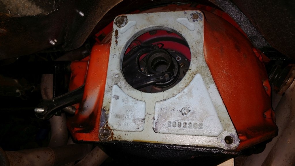

I go out there this morning in my shorts (42F on the ridge this morning) to check the bellhousing, fearing the worst:
Ahhhhh. What a relief.
2892262 11" clutch A-833 1968 B-body C-body 383 440 4.80" IBR (cast dates include 9/5/67 10/20/67) Cast Iron
It's the RIGHT bellhousing. :thumbsup:
Thank god for small miracles....
Brewer's says to use the 143 tooth 11" flywheel with this bellhousing.
