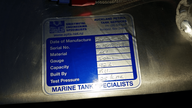

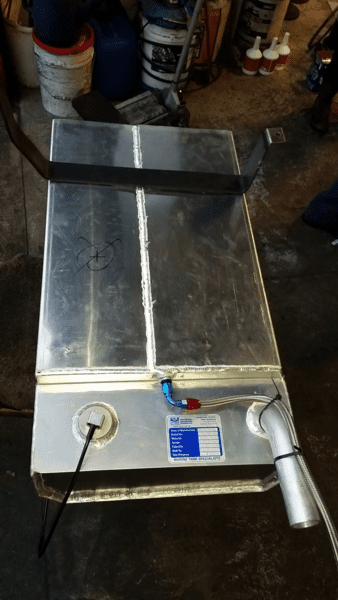

Same problem here....External fuel pump, increased capacity ....92 litres instead of around 60, and a nice clean tank without the filling issues ...

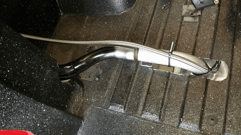

Building a metal shroud to cover the pipe ...eventually. Currently has a wooden box to conceal the hole. :)

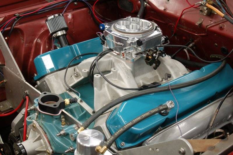

what's up with the motor plate. you put extra ears on it and why if you don't mine. andy the engine bay is looking sweet as the rest of the car.
