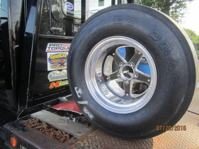

I had the ET streets,the new ones are ET /STREET R.They seem to hook better.I fit the 16.5X31. IMOP you can't run a tire in the street and expect great porformance at the track. I have a set of M/T E/t drag 10.5W for the track.

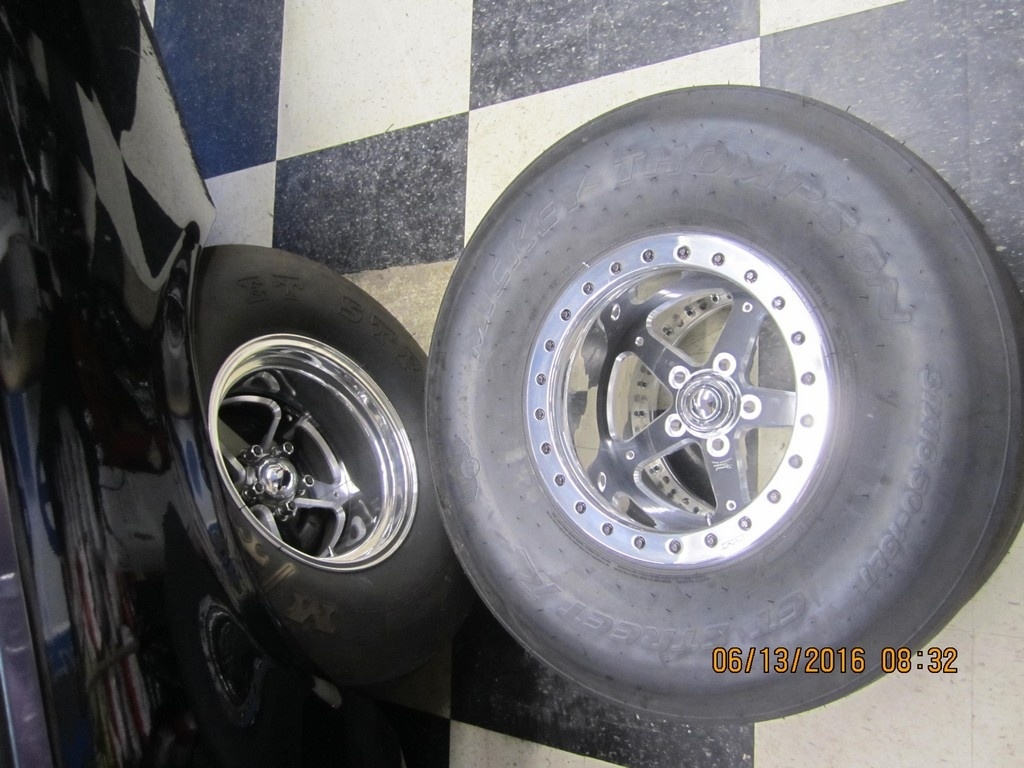

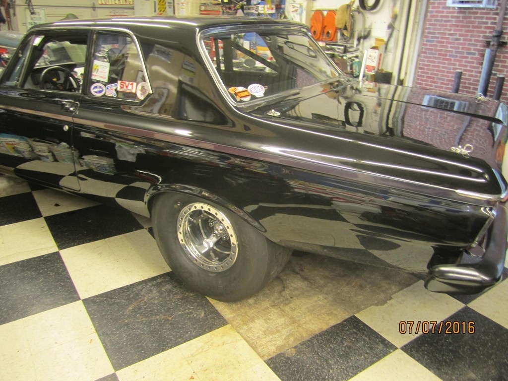

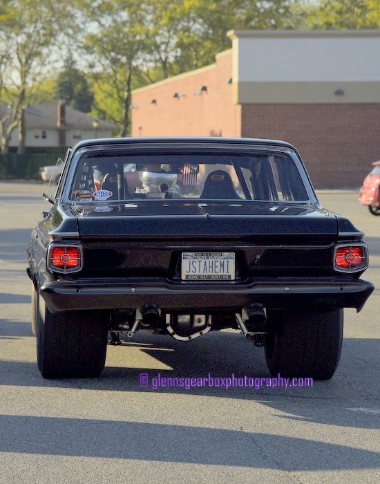

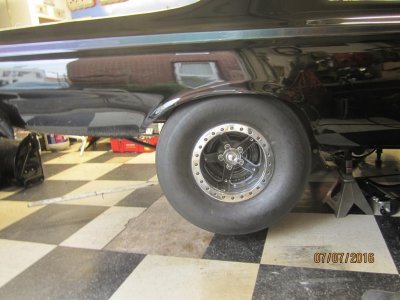

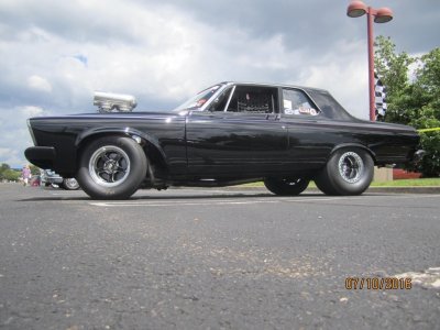

6.13.16 012.jpg 7.7.16 008.jpg 7.7.16 010.jpg 7.7.16 011.jpg 7.10.16 042.jpg 7.20.16 002.jpg 13907047_10207230611144624_2044886370283372516_n.jpg 14188385_10210457686857928_836531961372807205_o.jpg IMG_4553.jpg

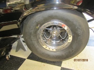

I use the Hoosier 30 x 9 radial slicks and I drive on the street with them all the time. I am very happy with them as my car is very consident on them. Ron
How are you guys even running a tire taller than 30"? I get your probably mini tubbed but you must have replaced the entire wheel well instead of just stretching the factory ones. I've always thought My Mini tubbed 66 with the rear moved back 1" (using US CAR TOOL inboard kit) would only support a 30" maximum tire diameter?
Thanks Hemi-Itis, I'm torn between having two sets. A street set and a track set. I would rather just have one since it is street driven quite often. Ron, now you got me thinking to ditch the quick time pros and just get a straight slick and drive it in the street. My car will never see a drive in the rain. Thanks for the photos you guys have awesome cars!!
