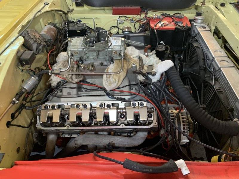

I am looking at entering my A12 in to Hot Rod/Motortrend Drag week 2020 since it's all Midwest and I happen to have a decent amount of time off accumulated.
I have Edelbrock Victor heads, they are not reported as Billet, however the Drag week rules for Street cars forbid them ( and a few other parts I can swap easy) otherwise I will have to go up a class to Modified and keep the car as she sits.
does anyone know if they are considered billet or not?
5E808810-0176-4F62-AEA2-C43C56186FD4.jpeg 3EE3B4E3-7F7F-4059-8ABA-A2593B3675BA.jpeg
They are cast heads, i would seriously doubt that they would be prohibited as billet. Billet is probably referring to "carved from a solid piece" like top fuel and top alcohol parts.
That's what I was thinking. Far price wise also from the billet heads. I will remove the other parts off to stay in the lower class
Thanks, I am just after a good time, my car isn't even close to winning a class
