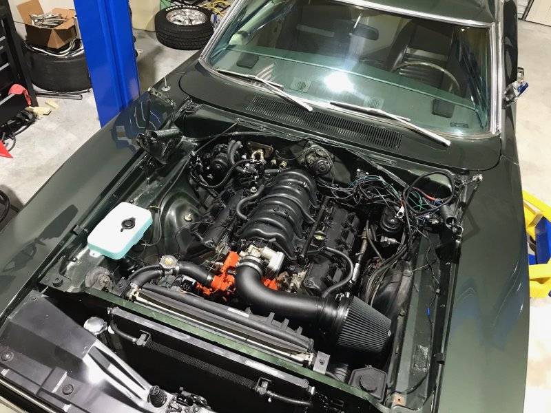

I'm really happy with my G3 Hemi swap in my 68 Charger.
I also used the NAG1 5 speed auto with my swap.
As others have mentioned highlights are -
Fuel injection, great power and torque, fuel economy increase, ability to run alternative fuels (such as E85).
I run a Holley Terminator-X computer system for the Hemi and a Russell Drake PCS controller for the transmission ( PCS – Sound German Automotive ).
My car has an Aeromotive fuel tank with a Stealth pump and PTFE fuel lines with return.
I run my car on E85 full time and it makes great power! Plus E85 is much cheaper per gallon that standard pump gas. I get between 13-15 mpg around town on E85, but have seen it get 20 mpg on highway with pump gas (93) with my 3.73 gears.
TTI Exhaust makes the best headers for fitting this in your car and I run their 1-3/4" long tubes on mine with a 3" exhaust.
If you can, try to source a 6.4 Hemi for best overall power/torque. However the little 5.7 Hemi is what I have and works well ( I bought a wrecked 2006 Dodge Charger Daytona for my swap for only $1,250).
