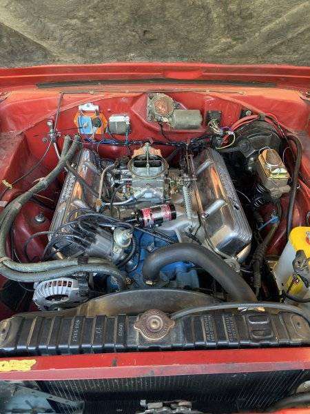

Been messing around with coils in my car, got a MSD high vibration (can be mounted horizontal) and this thing gets smoking hot after 5 min of idling. Engine starts spurting and then does. The. Takes a quite a few cranks to fire back up. Is this normal? I did jump the ballast resistor.
67 cornet
440/727
Mopar orange box with no name electronic distb
Just required the engine and upgraded the volt reg and alternator too.
As others have said unstrap the ballast, measure the ballast as you want .5 ohm not .25 ohm. That coil and the accel coils wants a .7-.8 ohm ballast but I have run them with
.5 ohm for years no issues. If you go too high like 1.5 they like to miss at high rpm, weaker spark.
67 cornet
440/727

update, unplugged the jumper on the BR and took it out for a quick 5 min drive. Came home and pulled in the garage to check and top off the tranny fluid while the car was idiling in N then it dies and won’t fire back up.
Took some readings with the key on
Battery-12.26v
BR is at 11.26 & 6.8
Coil is at +6.75 -2.14
Check my ign switch and was getting 12.25 there.
BR is at 0.8ohm
Swapped the coil, nothing. swapped the ECU, nothing.
Any ideas why it won’t fire up? When it sits for like 5min it will fire up for 1 sec then die and won’t fire again. Car is getting fuel and spark. Checked it with a inline spark plug tester.
It might be flooding; leaving it sit for awhile allows the excess fuel to evaporate, but could still be hard to start. Do you have another carb you could try?
This comment struck me, as I just recently experienced the same thing. Long story short, the reluctor gap was a bit too large. Readjusting it to .008 made a big difference. Probably not your problem, but since I did not see it mentioned previously, I thought it might be worth an honorable mention. Can't hurt to check it. Just be sure to use a brass feeler gauge.
Thanks, I adjusted it about 50 miles ago. I’ll re check it. Think this could be failing when it gets hot and may need to replace it
