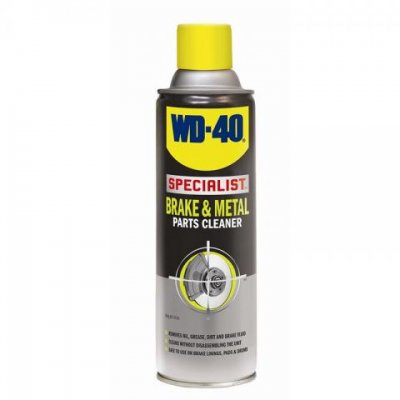

Brake cleaner will clean it, and will not leave a residue like carb cleaner.
