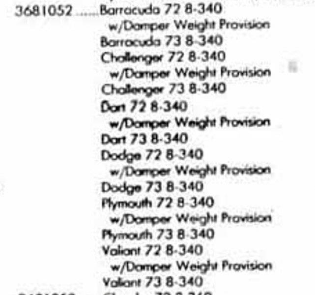

Can someone help me decode this one: PK 3681052 4136 1076
Would this be from a 1972 340 Cuda
Could be...
4136 is the build date November 24, 1972 so it's actually a '73 model year. VIN stamped on the bellhousing will tell more.
All these questions for decoding and I posted the complete listing of transmissions and their numbers for ya...(#12 post above)
Click and open the pdf and look up the number... its not rocket appliances (Rickyizm from trailer park boys):poke:
