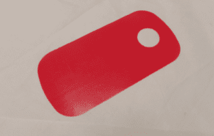

How about something like this that temporally gets attached while fueling? Maybe like a magnetic sign but a fuel deflector instead.... Doesn't solve the problem but at least it prevents paint damage...
