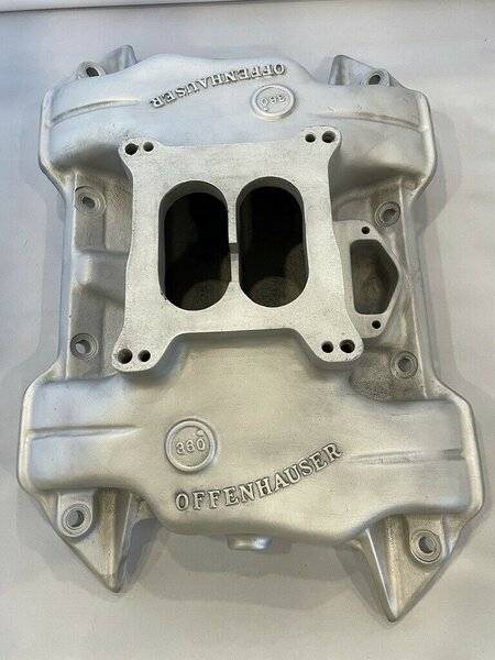

I recently bought an Offenhauser 360* intake identical to the one shown here.
The application is my '65 Coronet 383 [out .030]/727/3.23 [for now] rear gear. A 4.10 gear is planned for the near future.
The engine has a slightly lumpy [no cam card, bought it this way], has headman headers, and electronic ignition.
I plan on using it with a Holley [list 4779 DP]......
The goal is to get good low RPM performance and torque.
Sooooo......how will it work?
Thanks!
I used one in 1970 on a 413. Old technology. Basically a single plane so low end is not its strong point. Much better intakes out there.

I realize that it is old technology, but you did answer my question about the low-end performance. Probably as interested in the nostalgia look as anything else. I really have no intention of hammering the "happy button" routinely. I also have an Edelbrock DP4B that I might try. I have a vintage Edelbrock Tarantula TM6 w/a 600 Edelbrock carb on it now.....any thoughts?.....thanks...

Like ****
Go with the Edelbrock DP4B if you want off idle Torque and Cruising Low RPM performance on the street say to 5,000 - 5,500 RPMs or so
Weiand Action Plus Dual Plane
Edelbrock Performer
These are all off idle low RPM performance and Torque for the street
CH4B and DP4B are basically the same manifold, an early two plane design, ch for chrysler meaning a rb application, the dp for dodge/plymouth for a b block.
Either would be better than the offy. It is a low rise single plane with very short runners. The short runners kill low end, the low rise and awkward runner layout kills top end. To tell the truth, i think your tm6 is better everywhere. I think you would be happier with any of the two-planes mentioned above. Dp4b would work fine.
My buddy had a Offy 360 on his 440 Duster. Comp 305 H cam, headers, 3.91. I looked at it. Looked like the flattest manifold I had ever seen. We put a Eddy Performer RPM on it. Picked up .6 in the 1/4. That's correct, 6 tenths in the 1/4. He said the RPM is the greatest thing ever. I said no. Your old intake was worse than a stock piece.

Depending on how it's built and your stall speed that 750 double pumper will be a bit much. I'd rather use a 3310 vacuum secondary. The 4779 is a great carb, but you probably experience some bogging off the line. I also agree if youre looking for low end torque. Use a dual plane too.
I'll agree with the DP4B for all-around, and TM-6 for all out.
