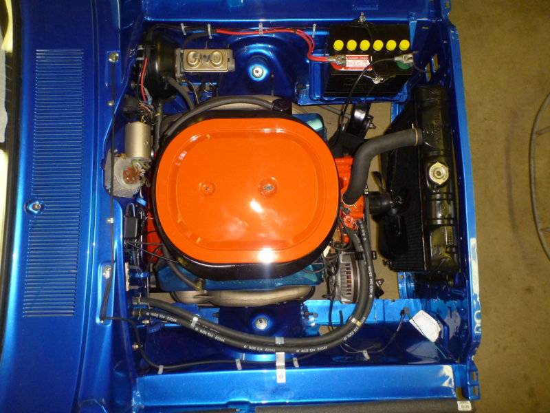

Got headers out of my system when I was 18... almost 40 years later now and this is how it's gonna be until I'm gone, well unless I build a '68 Dart.. LOL
