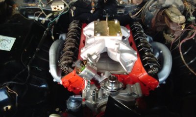

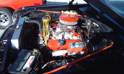

Just finished putting a 400 stroked BB into a 76 Aspen R/T. HP exhausts cost $150.00 and the exhaust shop cost us $120.00 to run them into the mufflers. So it is always up to the owner to decide. What do you want is the first thing to decide.
